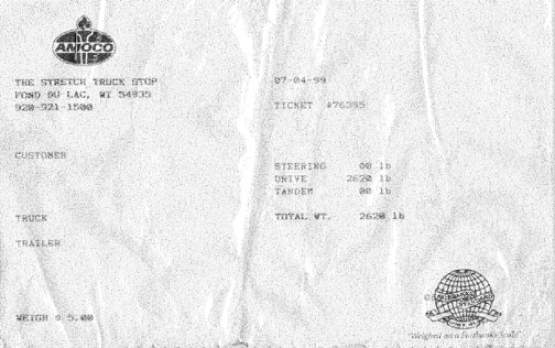

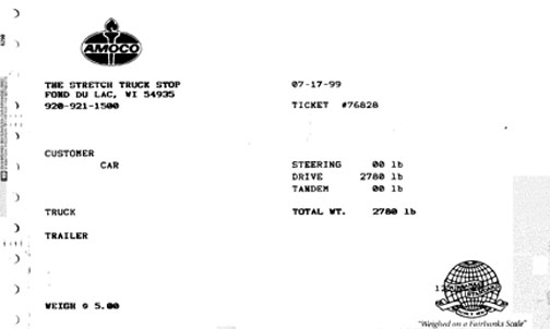

Dave, what does the weight slip say about accuracy? I weighed one of my cars on a truck scale a few years ago and the scale read in something like 20 lb increments. Comparing two cars on that particular scale could have up to 40 lbs of error.
I'd really really like to see the somebody do a weight comparison on a good set of four pad race scales. This would weigh each corner of the car to the pound. Total weight would be exact and it would be also interesting to see what happened with corner weights.

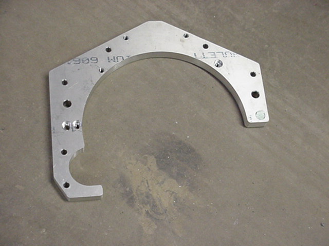

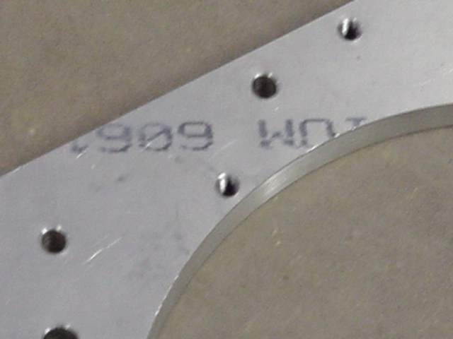

Have any of you guys actually picked up and held the Archie engine adapter plate? It's a big, ugly, heavy piece of steel. For the money that the Archie kit costs, he should be embarrassed that it's not 6061(and the video too ... .but that's getting off topic).
That plate is adding a ton of weight that there is no reason to be added. Less is always better.
The solid engine mount also uses a much more material then is needed. And if you need to weld, how much of a kit is it?

I thought Archie's engine adapter was aluminum??? I also have never heard of having to do any welding with the kit???
Howard, are you sure you're talking about the right V8 kit?
