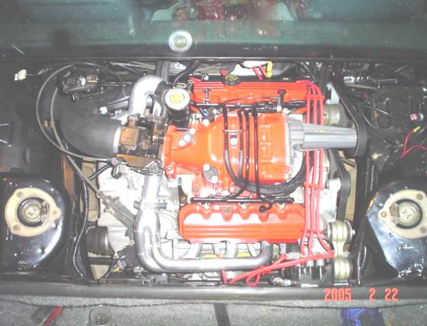

I started a Thread a while back with some pictures of my install but cant not find it now. I figured since my install in 98% done that I would start a new one showing off the work I have put into it so far. I started this project back in April and it has lastest longer than expected but going to be well worth it. The car is an 88 T-Top coupe that a friend of mine gave me and the motor is a 97 L-67 on the 4T65EHD transmission. The pictures of the car were taken right after I got it home so one of the T-Tops look odd(glass was replaced with plexiglass by PO). After the swap is complete and on the road with all the bugs worked out, the car will get an aero package on it and repainted. At the same time or maybe even sooner I will put some new shoes on it, 17 X 7 TSW RIbs wrapped in Toyo Proxes. The motor is stock for now and remain fairly stock with only a smaller pulley and maybe some Gen 1 rockers added down the road. The motor has had several parts removed from it to make it a clean install and will get some PBJ fuel rails added once I break down and spend the money on for them. The pictures I have of the motor now do not have some of the parts on it, intake tube,fuel lines, ect but more pictures will be taken and added later. I want to thank all the forum members who have answered my many questions about the install and thank Cliff for PFF. I would like to give a special thanks to FastFieros(Loyde) for answering all my questions and walking me thru any problems I had during the build up and install. I wish I would have taken more pictures during the install but will have to do that on the next one(5 speed/L-67 into an 88 GT). So without anymore rambling on here are the picutures.................
88 T-Top Coupe
L-67 with 4T65EHD
Installed in Car

Very cool! I'm looking forward to seeing more. The 3800SC is something I'd like to do at some point.
I also am curious as to what the TSW Ribs will look like on the car. I came about this close >.< to buying a set in staggered sizes/offsets for my car, before I found my present wheels.

Huh only 1 pic???
oh I see it is NAPPY time for lil' mstang boy

One question, though... How are you going to put oil in it? You can swap the valve covers, you know...
I like the wheels too... My GT is wearing a set of discontinued TSW Hockenheim R's.

saw you said possibly rockers, if you do it, throw some valve springs in don't make the same mistake as me. I'm getting valve float up top fixing it this spring with LS6 springs looks great.

I had the VC swaped but then swapped them back to get the oil cap out of the way. I will fill it with a flexable funnel that I have seen at many auto parts stores. I bought the TSW I ahve off E-Bay from the scratch and dent bin, they have a few dings but nothing to bad. I only payed $230.00 shipped for them so I got a good deal on them.

Yeah that is what I have heard from several ppl. I bought a ZZP XP Hot Cam Kit for the motor but decided to hold off and put it in lower milage motor. I want to build up another motor after my 5 speed L-67 for the track.

a newer thing the GTP folks are starting is to get the outside of the supercharger jet hot coated
or atleast some form of ceramic coating it looks awsome and will keep the heat down

Cut / shave those dam engine cover brackets off the fuel rail ! they are fugly

Running kinda late of posting any new pictures but had to work the last 7 days str8(those being 13 hour days). Then after putting on my engine harness, my back started bothering me so I finally went to the chiroprator to find out I had a slip disk. But I finally got to work on it today and am about 99% done, just ran out of time cause I have to go back to work. I hate being so close but would rather take alittle more time and not make any last minute mistakes. The new picture is with everything that is going on the motor, still pretty clean but will be better with some PRJ fuel rails. Hopefully by next Monday it will be running and possibly on the road.

You are going to want to check into this here:
Your fuel lines will come right off that rail unless you get something on there to make sure that they are secure. From the pics that you have taken, they look like they are just pushed on there to get line lengths, and I hope that this is the case. Lots of fuel going over the place is not going to be good on such a good looking install!
Also talk to me about that intake, as Im looking for one like that myself!

Hey Steven, I changed the lighting a little to note the wiring and hoses a little better. You laid that harness I built in there real nice.

Yeah--I have clamps on the fuel lines now, I just ran out of them and had to get a few from work so that part is covered. So should be no issue with them coming off and causing mass destuction.

Once again what you said was exactly how it went. The harness layed in there without a hitch, only a few connectors hard to get to but not impossible with a little bending and stretching. I got my ICM harness extended and it went on perfect also. I had planned on having it at the next NTFC meet but since I ran into the back issue, it has slowed me down. But it should be running and on the road by next week if nothing changes in my plans, which always happens. Once again thanks for all the help with the swap and I recommend you to anyone needing a harness or a swap done.

That looks SWEET!!! How does it perform???? Hope as good as it looks! What do you do that keeps you so many hours per week from your toy? That's a hell of a lotta work!
Thanks for the complimants from the various ppl. It will be cranked for the first time tomorrow so I will get back to you on the perform part. As for the work part, I work about 55-70 hours a week at my job depending on the customers needs. Then the time I do have off, I have a wife and 2 little boys to spend time with. So between work, family and then the car it has taken some time to complete but well worth it now it is done. I will have an update tomorrow and maybe even a short video of it being cranked for the first time tomorrow.

I started it for the first time about an hour ago, thought I would be nervous but really wasnt at all. Guess I had confidence in the work that was put into by myself and Lyode on the engine harness. I didnt run it very long, didnt have exhaust fully on and it was rather loud. Have ran into my first problem already, but nothing major, the thermostat housing I make has a pin hole leak in my weld but an easy fix. I had to shut down and get ready for work but will work a little more on it tomorrow if work goes well for me tonight. I plannned of making a video of the first time I cranked it but batteries were dead in the digital camera. I plan on making a short one next time I start it up.

Got the exhaust on and setup right so there are no leaks but have a slight rattle from where the Y-pipe meets the 90 going to the exhaust. TheY- pipe drops down very close to the frame and the nut is vibrating against the frame when running, have to get a bolt with a thinner head on it for the fix. The only other issues is a slightly high idle that will be taken care of once it is on the road. Found a leaky plug wire(hurts when you grab a leaky wire) that was causing slight miss and got that fixed. Still have to bleed the brakes so I can do a road test, was going to happen today but housing shopping ruled that out. I made a short video of the motor and it running but not forsure how to post it on here. I should have it one the roas by next week and driving it daily shortly afterwards. If anyone can help me post the video I would appreciate it.
