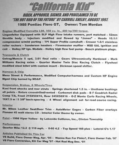

I think CAKID ran next to a Viper and the speed was up there. Look at the top speed.

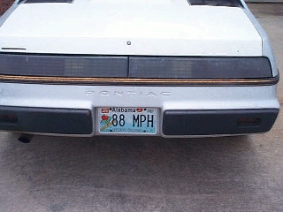

My v8 will only go 85 MPH for some reason.

Rrunner had his V-8 IMSA up over 200 MPH if I remember correctly !
see link posted above... he believes he could - but hasn't (at least as of that posting)
