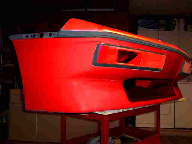

To anyone who would want to try this mod you need a "standard front spoiler" from the fiero warehouse, fiberglass repair kit, rubber bumper repair, bondo, and 1 rubbermaid hamper lid(for support)
Tools
Roto zip, dremmel, rivet gun, lots and lots of sand paper, and some elbow grease

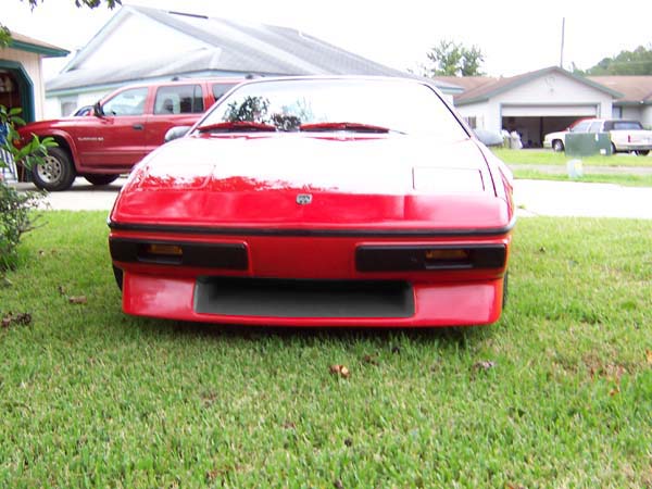

Update on the nose.
Running out of time for Daytona so I got my little Bro to help out.
My Dad got it painted Saturday.
Got it mounted tonite. Pics aren't that good, if I get a chance I'll take some more.
I don't know what happened to that last pic. It almost looks like I don't have a passenger headlight.
Bonzo

Report this Post04-12-2005 08:53 PM Click Here to See the Profile for bonzoSend a Private Message to bonzoDirect Link to This Post
It's been awhile since Daytona and I havent had a chance to post any updates on the nose. I've been busy helping my Dad reside the house and build a pool deck. We had a deal, He would help on the car then I would help on the house. It worked out good. I won Best of Show Daily Driver.
Here is the latest pic. I hope to get out and take some more pics this weekend.
Bonzo

I have had a few PMs about this nose. I have answered most but I figure it wold be easier if I post it here.
The nose is a fiberglass chin spoiler from the Fiero Warehouse. I riveted the piece to the nose with some rear metal strip backing. I then fiberglassed the back of it for more strength. I then used Rubber Bumper Repair Kit for the front. This stuff does not sand easily. With a littlle bit of Bondo and alot of elbow grease I sanded it smooth. My Dad Primered and had me sand again 3 times until he would put the final coat.
Here are a few pics. I wish I had photoed every step.
Bonzo
