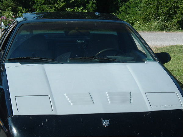

fierodustin_86
Posts: 970
From: Joplin, Missouri
Report this Post08-08-2005 09:28 PM Click Here to See the Profile for fierodustin_86Send a Private Message to fierodustin_86Direct Link to This Post
Not painted yet, but here is mine.
Doooh!!!! page 2 is mine!!!
[This message has been edited by fierodustin_86 (edited 08-08-2005).]

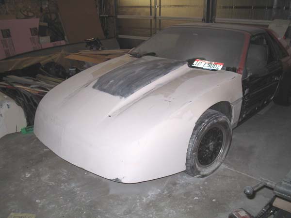

A little progress made on mine... Its not even half done *sigh*

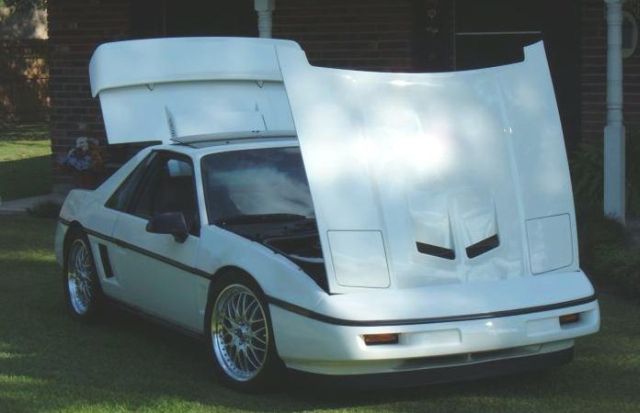

I'll play, here is IZA TOYS hood
Thank you,
IZA TOY's build thread here www.cyclecreationsws.com
How do you plan to open the hood?

This is just a buildup of the plug for the front end mold; it will be separated at the fender line where the trim piece is missing. I built the plug with the parts mounted to the car to reduce any warping or misalignment. Once I get it to a finished state, I will fiberglass a 2 piece mold of the front, pull the mold... and wash and scrape off all of the buildup.... its amazing how perfect sheetrock putty is for design work. Once you get something you like all you have to do is clear seal it, pull your mold and then wash and scrape it all off your original parts and then you can buildup another design
[edit] It will open just like Norms front end on Rverhalen's car... except the front end framework won't be removed.

Nice idea!

but where are the lights, unless you plan on never driving at night or turning?

This is a plug, as I stated above... as in... I will add headlight buckets to the front end once the final piece is pulled from the mold.
