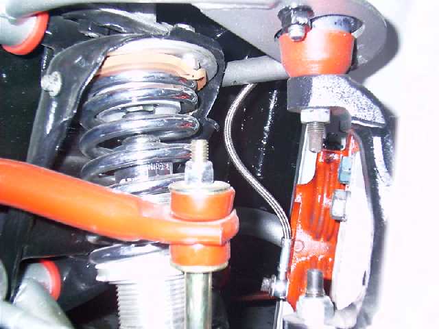

Well just finished the brakes ...................
and on to the Intercooler

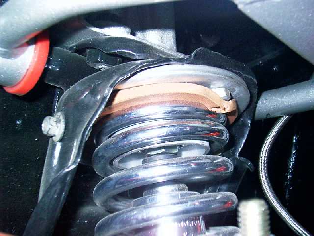

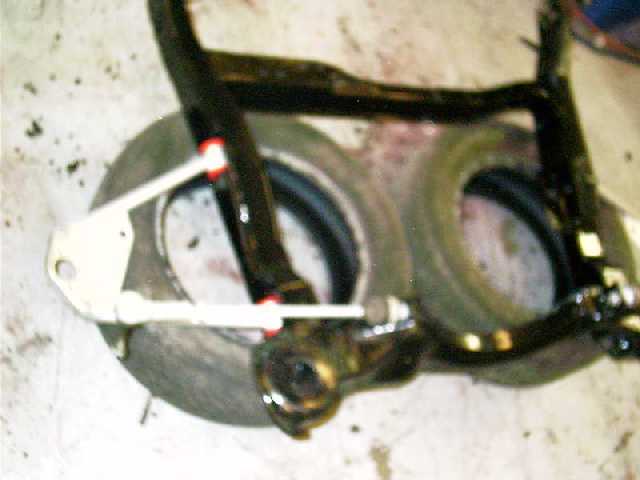

Would you mind posting more detailed/better lit or focused pics of the way the upper end of the RCC front coil overs attach to the crossmember? Was any cutting involved?
PURPLE REIGN
Posts: 4080
From: Minnesnowta ------------------ Land of White Gold
Total ratings: 303
Report this Post06-19-2003 10:27 PM Click Here to See the Profile for PURPLE REIGNSend a Private Message to PURPLE REIGNDirect Link to This Post

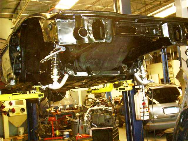

Yep.....I'll try that.
Yes you need to cut out the bumpstop cone section, that is where the coilover attaches. drill 3 holes & bolt together.

Report this Post06-20-2003 10:04 AM Click Here to See the Profile for PURPLE REIGNSend a Private Message to PURPLE REIGNDirect Link to This Post
PURPLE REIGN
4080 posts
Member since Sep 2002
Here you go .......

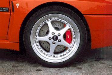

Shawn (& Chad)- the brakes look awesome! I still want to see if you guys can cram a 17" wheel around those setups (I'd love to look through the wheel and see only brake )
Posche Example Shown
Lookin' forwad to going for a ride tomorrow too...

Purple, Im hoping to learn what yall did and put the 13 HD rotors from the C4, Is there any specific caliper you used because I can get the Fbody ones for 120 and rotors for 110. All I would have to make is the brackets for the calipers to mount. I have the factory hubs machined down already.
N*,13" stoppers, 18s, completely rebuilt, oh yea and this:

You've got the right formula, now all you need are the brackets. We'll see what we can do about that
MOBILE
Posts: 768
From: Linwood, MN, USA
Registered: May 2002
Report this Post06-20-2003 02:13 PM Click Here to See the Profile for MOBILESend a Private Message to MOBILEDirect Link to This Post
86 FIERO GT:
When PURPLE and I asked for calipers, I believe we just said '98 and newer F-body. The are a HUGE 2 piston aluminum caliper made for the 12" F body rotor, and fit flawlessly over the 13" HD rotors. I don't believe that GM used more than one caliper those years, but if you're worried, tell them it is a Z28 or SS and I'm sure you'll get the same ones we have. For more info on the research see my thread on FINALLY PICS OF THE 13"s! As far as rotors we just drilled a 5x100 ofset of the corvette pattern. It works great from what PURPLE told me yesterday, and we only have the fronts done!!!! I can't wait for the rears!!

I saw someone throw up prices for those rotors and calipers and I cannot find a supplier for those kinds of prices. Does someone have an inside deal here? How about some sources. I checked with Advanced Auto, and they cannot get the rotors and the calpiers were like $75. Anyone?
85 SE 2M6 "Fiero Addiction"
85 SE SC3800 Series II 5-Speed
PURPLE REIGN
Posts: 4080
Total ratings: 303
Report this Post07-02-2003 09:07 PM Click Here to See the Profile for PURPLE REIGNSend a Private Message to PURPLE REIGNDirect Link to This Post

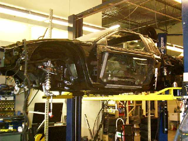

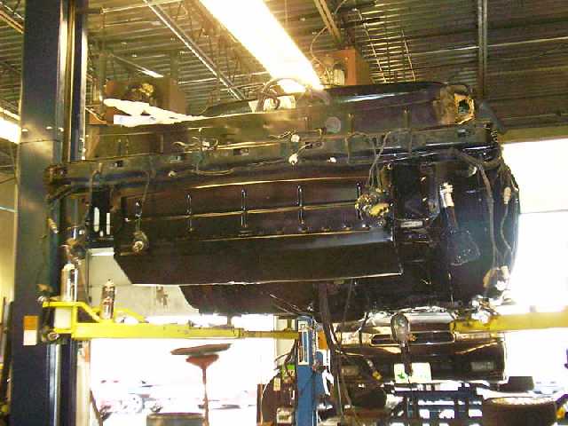

Yes those are inside prices, usually shop cost since I own my own business. Rotors at my cost are $75 for regular ones and $110 for the crossdrilled & slotted, calipers were $35 a piece from a salvage yard, since a car that new surely didnt get junked for bad brakes.

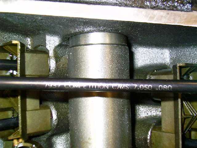

And so I went and dug up some build -up pics....................we'll start out with the donor car, an 87 Silver GT from N.J. with 156,000 and a blown engine. We were supposed to stop & visit with Ski & Jen but weather was HORRIBLE and already set back with a little run in with the N.Y. port authority. Car was complete but a little rough, all I wanted was the clean frame anyhow.
after the car is completely stripped & coated with Pour-15, EVERYTHING gets removed & sandblasted & painted, then the tubular suspension is on it's way in.......

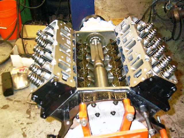

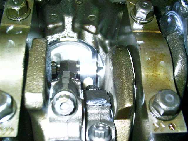

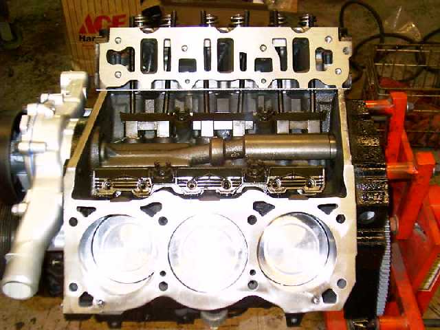

after the suspesion is in we move on to the build of the motor. Start by stripping a 60,000mile Riviera driveline. Install Forged Racing pistons with ARP bolts & conditioned rods................
once we get the heads on (ported & polished) its time to start closing up the engine..............

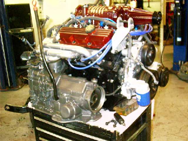

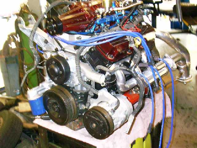

then we finish up the engine side of things.............
and of course the drivetrain has to be mounted on something...................

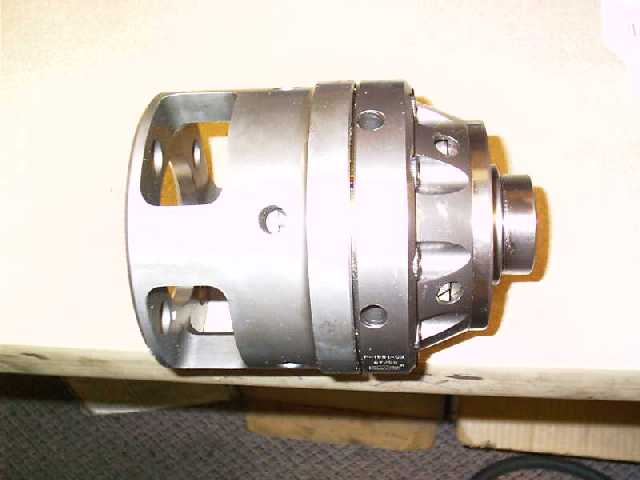

and then there's the Quaife Torque Biasing diff for $1400...................
