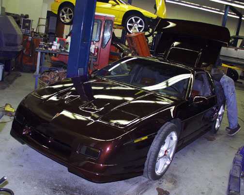

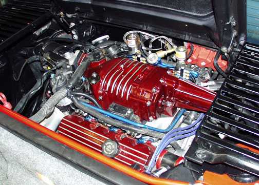

Not to overload the thread with the build up pics, we'll just do the almost finished project. Aside from a 4 week delay due to a blown engine with 7 miles. The car still has wrinkles to be ironed out like any project. Still need to finish the horrible paintwork, 13" crossdrilled & slotted C-4 H.D. rotors with 99 F-body twin piston aluminum calipers, and currently installing stage 2 intercooler, stage 4 blower, LS-1 throttle body. Some other driveability issues etc.

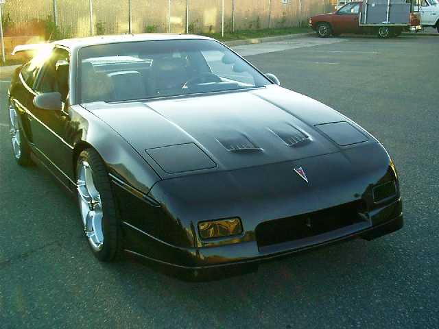

Cute car....

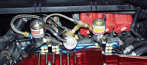

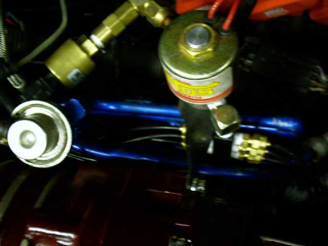

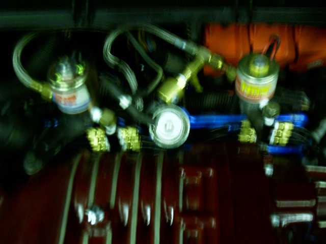

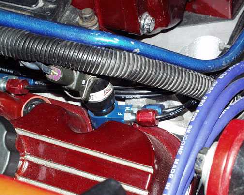

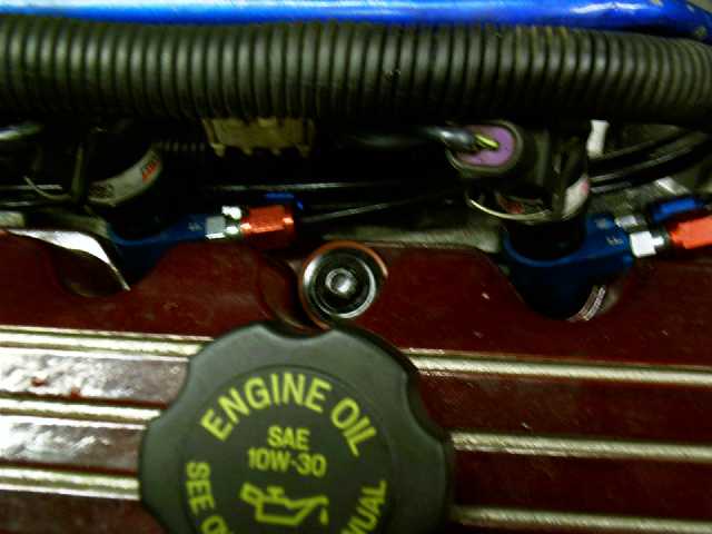

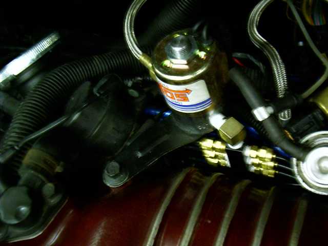

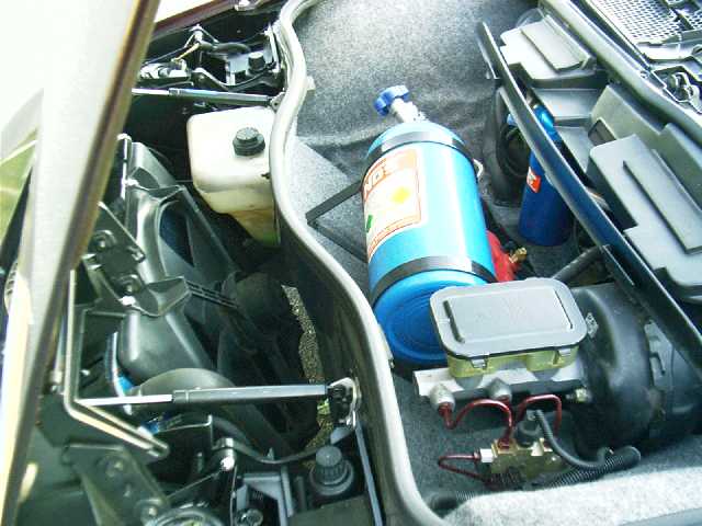

The last few pics are for LilDevil since he wanted pics of NOS solenoids installed.

Is that an 88 GT? Nice work on that car, looks awesome. - kv

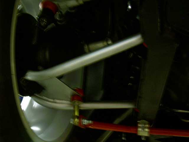

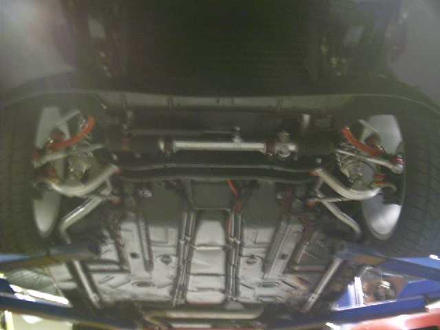

No it's actually an 87 GT with full tubular suspension & 4 corner coilovers from RCC

Check out my new 13" rotor thread to see the brakes this bad boy is getting within the next few days.....
Can anyone see whats REALLY in the oil cap picture???
Yeah that's right NOS baby,
"IT HAS, DIRECT PORT NITROUS INJECTION,"
"Enough to blow the welds off the intake" Sorry, just some FAST & FURIOUS humor......

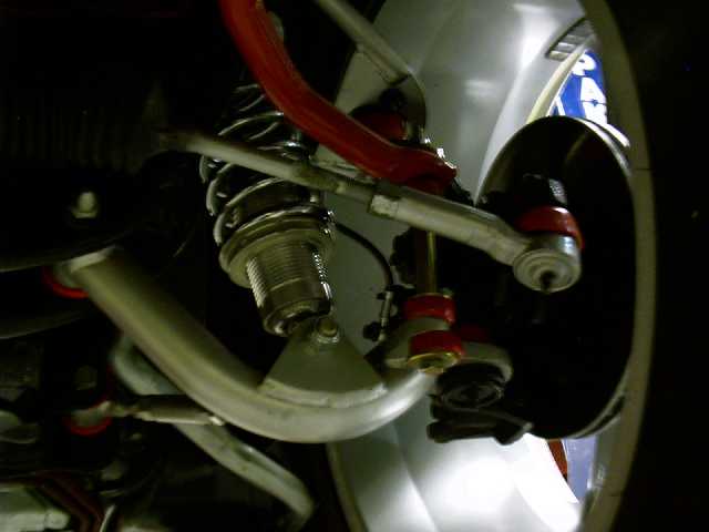

stop the insanity... no keep going! damn that thing is scary...

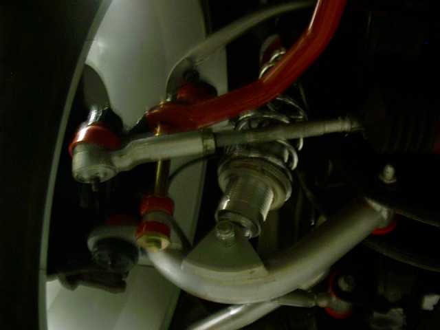

Those suspensions parts look interesting, are those a-arms custom fabbed? or will they fit on an 87?

Wow....that setup is simply insane. I love the engine color scheme. And NITROUS!!

Not to mention summit list's the NOSzle setup for 1400 dollars. I assume that is what you have since its under the injector. I give that a huge thumbs up.
James Z
Not custom. they are from RCC specialty and are engineered for the 84 to 87's .............check them out in TX at 817-536-3820
A full tubular setup with 4 corner coilovers is around $1500

Report this Post06-19-2003 12:08 PM Click Here to See the Profile for 86 FIERO GTSend a Private Message to 86 FIERO GTDirect Link to This Post
How much adjustability do you have with the front coil overs, right now i have helds rear kit and currently lookin for a front setup for my car. My choices are the help sport kit, RCC kit and the shelby customs kit. I dont really wanna go tubular but if I have to I will.
Yeah! Watch out! You don't want to blow your floor panels off!!!

Originally posted by Riceburner98:
Sweet. Yep, sweet. That car has waay waay too many goodies on it! So, is that the *only* way to get nitrous to a 3800SC, or just the *best* way? I'd like to put mine on the bottle when it's done and I get some miles on it, but I haven't even started to look at how. I really don't want to run it through the SC blades, how about a spacer plate after the SC with a fogger? Or tapped into the side of a nice intercooler... Between you and Skitime, there's going to be no trophies left to win at any shows!!! LOL Can't wait to see the brakes... <edit - I hit 400 posts! WOOHOO! lol)
Yes it is the Direct Port system for about $1400, the only down side is it does not fit the Series II SC with the injection way down in the hole. So I had to machine the head & the valve cover to accomodate the Nozzle. If you are going to a 75hp or less bump you can use a dry fogger after the throttle body & be safe. Anything higher and it will need to be a "wet shot" meaning it will need fuel & nitrous together. The only safe way to do it is Direct Port, wether you drill into the head or manifold, or the Nozzle. I like your idea of injecting it into an Intercooler but there again it can only be a 75hp or less dry shot. If you try injecting a wet shot through a fogger nozzle like at the throttle body you run a very high risk of fuel puddling in the intake and detonate the fuel & blow the supercharger off the intake. If you plan on nitrous at 100hp of more, plan on installing Forged pistons.
The adjustability is awesome ( although a lot of work trying to spin the adjust-ring )
unfortunatly the only way to get front coilovers is with the tubular control arm. But if you have enough engineering aptitude you can buy a coilover shock and design your own mount brackets (probably what I should have done to save money) but I was also told there is a company out there who is doing front coilovers and retaining the stock control arms. LMK if i can help.

Yes Shelby customs makes a coilover kit that uses factory upper and lower arms. I am tryin to get that kit but only way to get intouch with them is the phone. My other possibility is using the Hal shocks from held with a custom made brackets. Im goin to run a 150 wet shot on my N*. I just want it for giggles and occasional use against a honda.

Build up details
Silver 87 GT from N.J. with 155,000 & blown engine.
EVERYTHING is gutted to the frame, cleaned, blasted, & painted or powdercoated,
97 Rivera 3800 SC driveline
4T65E H.D. trans
Diamond Racing Forged pistons
moly rings
reinforced wrist pins
Conditioned rods
ARP bolts
566 square cam on stock roller lifters
LS-1 springs
Titanium retainers
comp cams 7.050 pushrods
ported & polished heads
portmatched intake
cold air intake ( 88-91 CRX )
stainless valves
WCF headers
42.5lb injectors
LT-4 fuel pump
2.8 modular pulley
DHP PCM by Dave Buckshaw
Taylor wires
MSD ignition
TR-6 denso plugs
stage 4 blower --------------coming soon
stage 2 Intercooler----------done !!
LS-1 throttle body-----------coming soon
PRJ fuel rail ---------------done !!
150hp wet shot Direct Port Nitrous
Borla Stainless exhaust
race shift kit
Quaife Torque Biasing diff.

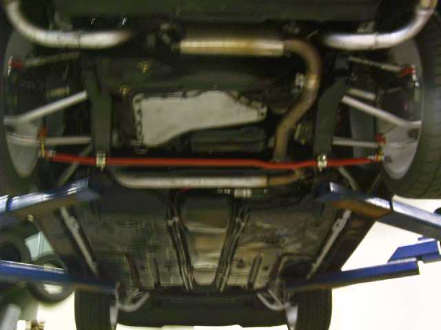

sitting atop a full tubular suspension with 4 corner coilovers on 245-35-r19's. 1" sway bar in front, 7/8 sway bar in rear,(was, now DONE!!) working on 13" crossdrilled & slotted C-4 H.D. rotors, 98 up F-body twin piston aluminum caliper's, Earl's steel braided lines, Mr Mike's leather ( last chunk of maroon he had ) ACC carpet, & other fun stuff...........................

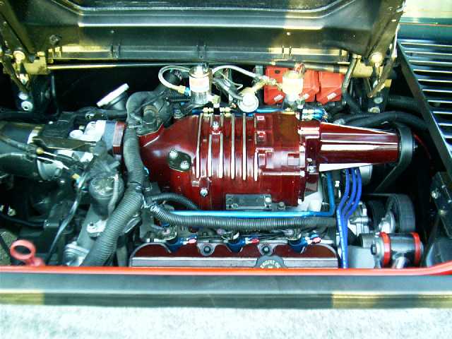

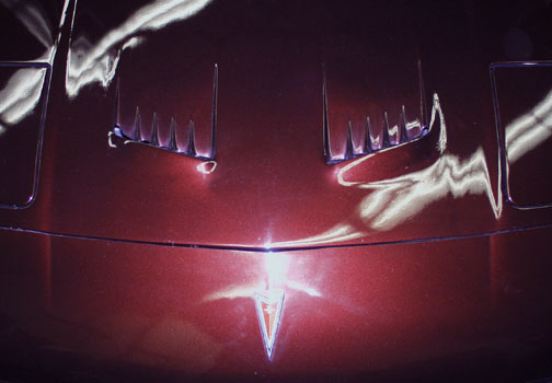

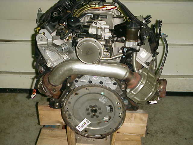

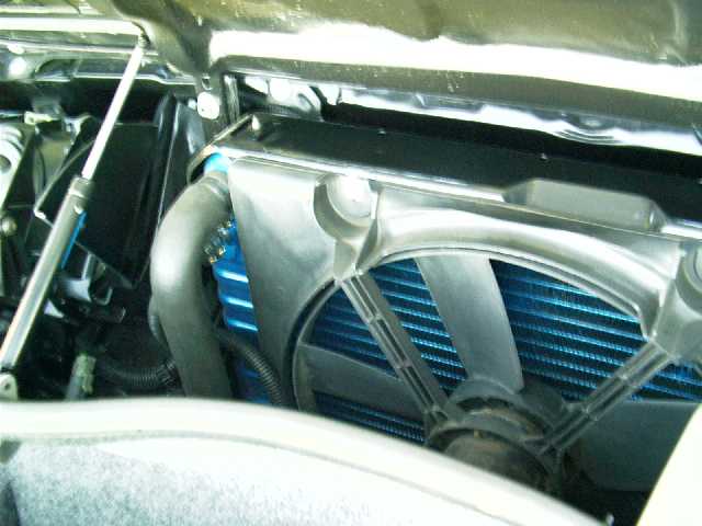

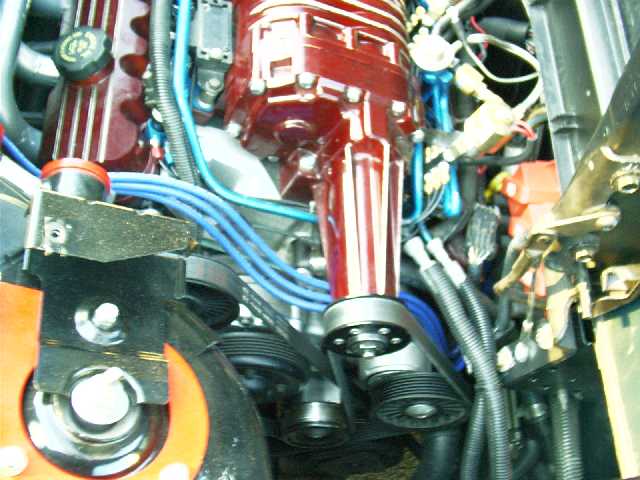

Hmmm... lemme see what I've got in the camera from last night...? BTW: The pics just don't do justice to the body color!
Here's another shot of the beautiful engine... it's amazing how nicely it matches the body color (for not having been painted at the same time or by the same methods)
Doesn't a set of Nitrous solenoids just look good with this engine?
A "tight" shot of the direct port nozzles
Watching it run in the shop- that'll put a big grin on your face!
My attempt at photographing the color- I guess I'd describe it as being a rich, dark, metallic burgundy.

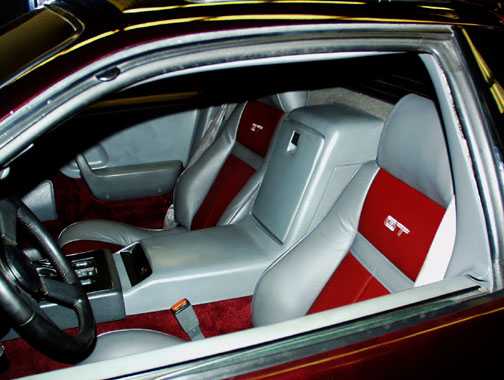

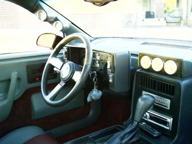

MinnGreenGT
11545 posts
Member since Jul 2001

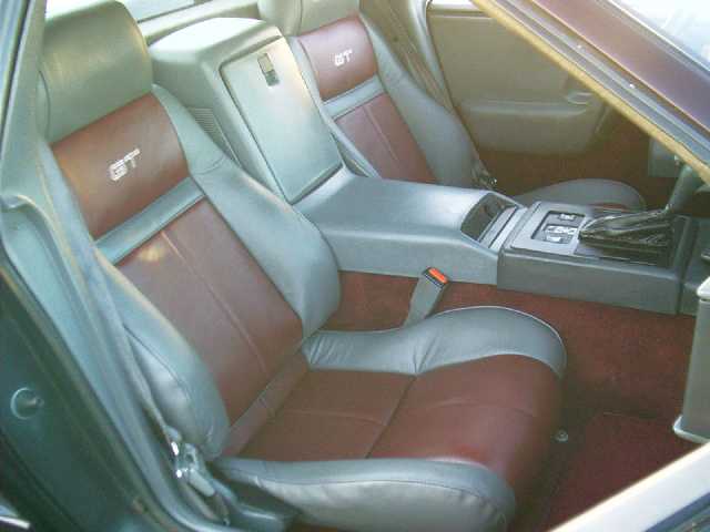

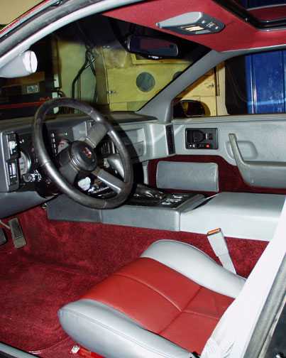

Great color-cordinated interior!
Hehe... he "Tweaked" it!
