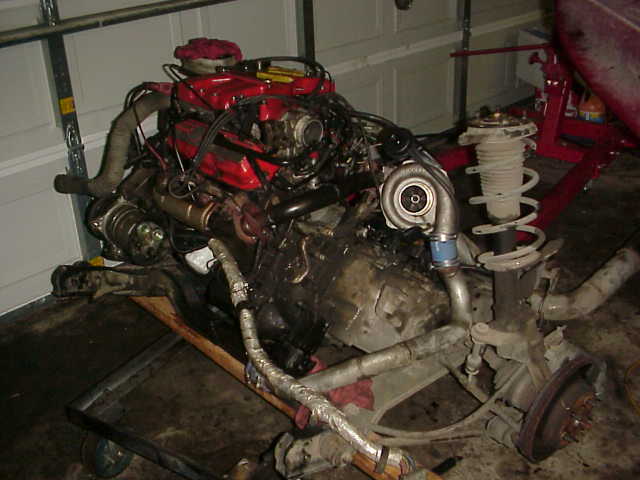

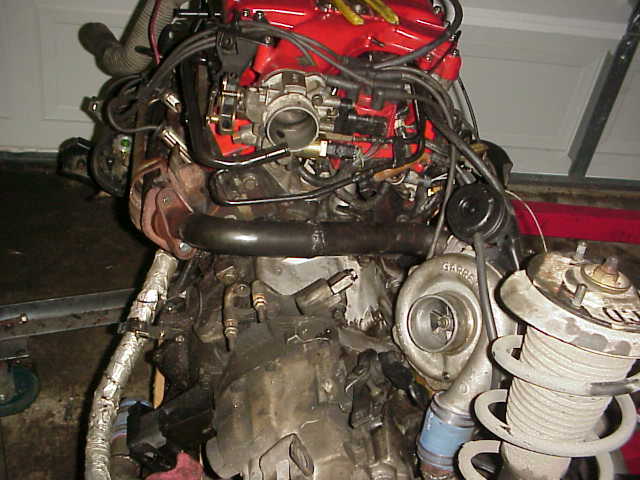

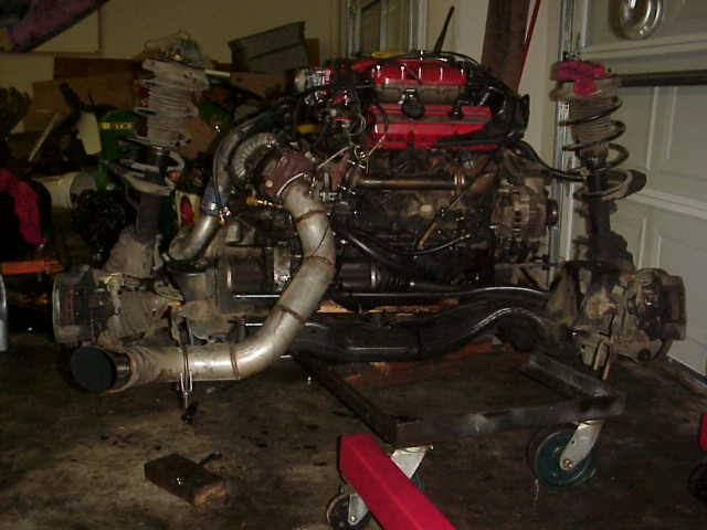

Here some pics of the some of the system installed with the engine out of the car. Everything is dirty because I just finished swapping in the clutch and new engine.

What about mounting the turbo where the cat is? Is there enough space there? Keep it coming
You can't. Turbo's use gravity to get the oil out of them - at the cat level, it'd just pool inside it (ok, unless you used some exotic pump setup to suck the oil out and shoot it back into the pan, etc...)
Here's how to do a remote turbo. Note the oil return pump. http://popularhotrodding.com/tech/0411phr_sts/
