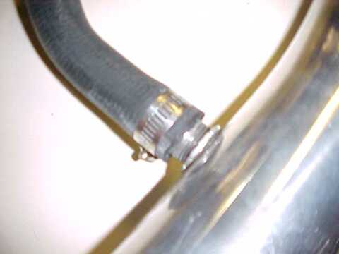

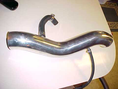

Above, the tube had 1 fitting on it and I needed 2 so I installed another one. The one with the bigger hose I used a 1/2 nipple drilled the hole and screwed it in. I placed it so It would connect back up to the original hose.
Above is a pic of it.

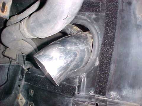

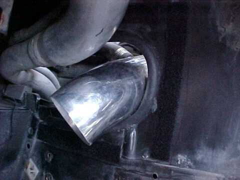

I cut a hose and used it around the opening to protect the alum. tube and prevent noise from any vibration.
I placed Velcro around the hole to hold the rubber mat I cut to seal up the hole. That way it will be easy to remove.

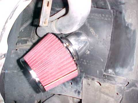

Filter with mat Velcroed in place.
If you look close you can see where the 2 hoses are connected. 1 is up under the tube near the TB is. Other is over where the original filter housing was, in fact I ended up using the original hose. My filter has a metal base, I drilled a hole in it and screwed the sensor into it, can't see it in the pic becuase it is on the back side of the filter.
So sensor is in where the filter is.

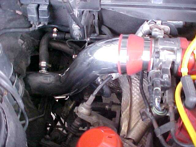

Nice work. That will be an interesting filter change. That gives me some ideas for my cold air tube thanks.
Hey where did you get the rubber tube that connects the throttle body to the tube?

It looks like the filter is in the wheel well. If that is correct isn't it going to get pluged up fast? Also if it is in the well wouldn't that be more of a low pressure area then the stock location?
Of course if my eyes decieve me and the filter is in the stock location then my question is what have you gained?

That is where the stock system gets its air from except there is just a pipe in that location and not a filter. I don't know about it getting dirty but it looks less restrictive witout that stock hose and canister.

No problem with the questions, The filter is in the stock location , inside my side scoop. You gain by no restrictions thru a filter stuck on the end of a 3" smooth bore pipe straight to the TB. The stock one is very restricted, take one apart and you will see what I mean !!You can both hear and feel the difference. I really like the sound it produces especially when you get into the throttle thru 1st and 2nd !!
I made it where it is very easy to service the filter. I cut a opening in the wheel well and then made a screw on cover from a piece of a spare fender well I had.

A blue one came with the kit I bought, I got the red one here www.ctamotorsports.com
Wasn't cheap though with shipping they charged....but I wanted Red and it was the only one I could find. I got the kit from PROAUTOSALON off Ebay it is called CIVIC/CRX 88-91 AIR INTAKE SYSTEM very cheap $33.00 shipped, (just ordered another one today) .

Zoom88

Zoom88, did you check on the PCV tube routing? That's a fairly important item that will shorten the life of your engine if unfiltered air is being drawn in through the PCV system. Also, the small tube is the cool air intake for the EGR solenoid which has its own filter, FWIW. Pulling cool air into the solenoid makes it last longer.
Another question: Do you think you get any heat gain from the coolant tube being next to the filter?
JazzMan
All the original hoses are connected. I don't know about the coolant tubing ... but I would thing the large amounts of air passing thru the side scoop would benefit both the coolant tube and the intake. One day after a long drive I will pull the wheel well cover and check it out.

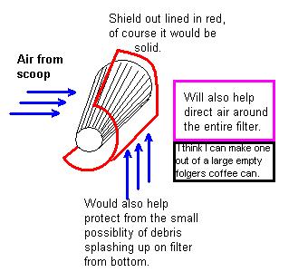

Also I got this Idea while making coffee to make a shield that will go around about 2/3 of the filter while still leaving about a 1 - 1 1/2" gap between it and the filter. I am not good at PSP so here is a rough idea of what I am thinking of.
Think it makes sense ?

I noticed that in the install pictures ther doesn't seem to be a provision for tha intake air temp sensor. I imagine an easy way to see how the stock Fiero intake and these Honda things compare would be by using a scanner and reading the intake air temps. Maybe that's too simple of a test.
I mentioned earlier in the post that the sensor is screwed into the solid metal backing of the filter. You can not see it because it is on the backside.

Report this Post02-29-2004 06:18 PM Click Here to See the Profile for JazzManSend a Private Message to JazzManDirect Link to This Post
The best place to test for air temp is in the throttle body neck just ahead of the throttle plate. I'm planning on doing some testing with this at some point this summer when the temps rise and I'll post results here.
Zoom88, in regards to the shield, that probably won't be a bad idea though, like you said, that area isn't prone to get a lot of junk.

Report this Post02-29-2004 06:27 PM Click Here to See the Profile for LoW_KeYSend a Private Message to LoW_KeYDirect Link to This Post
don't think you have to worry about stuff coming from the bottom I drove mine in the rain a few times and over a 1200 mile period looked new still
I wasn't expecting that I checked it out and was shocked, I was going to build a little box around the filter, but I said forget it after seeing how clean the filter was.

Report this Post02-29-2004 07:21 PM Click Here to See the Profile for TaurusThugSend a Private Message to TaurusThugDirect Link to This Post
where does the air temp sensor connect at? did you have to make a hole for it?
