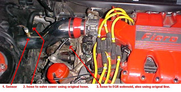

Sorry I didn't get to this sooner. Haven't been on as much lately. The velcro is holding up great. I used some electric motor cleaner to clean the areas I used the velcro on so they seemed to stick pretty good.
I have since moved the air temp sensor to the pipe in approx. the same location as it originally was. Here is a pic.
