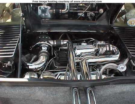

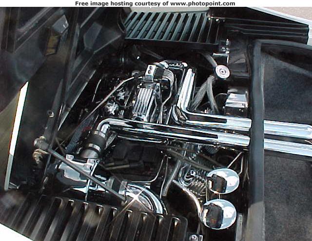

Report this Post01-18-2004 01:17 PM Click Here to See the Profile for FieroMaster88Send a Private Message to FieroMaster88Direct Link to This Post
FieroMaster88
7680 posts
Member since Nov 2000
Here are some pictures of this exact swap. I have no more informantion on this car, not even sure where I got the pictures from. It looks fast tho.

Report this Post01-18-2004 01:29 PM Click Here to See the Profile for ace35Send a Private Message to ace35Direct Link to This Post
WOW does that look sexy or what?! lol...as said before I LOVE CHROME!! haha thanks again!
