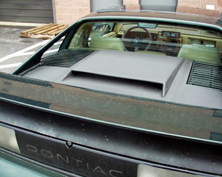

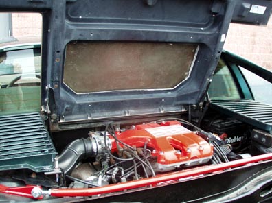

Here's a couple of pics of my 'Stang Style deck scoop:
And the inside of the decklid where I cut it out:
I purchased mine from the Fibersmith awhile back... and it needed a bit of extra prep work before fitting it (heck, I still have some "finishing" to do on it before paint).
If you're not sure about keeping it on the car, then you can just bolt it on (most people wouldn't even notice the difference until they get up close). But I did go ahead and 'glass mine in.
Here are a couple more old topics that you might find interesting as well: https://www.fiero.nl/forum/Archives/Archive-000001/HTML/20030204-2-023919.html https://www.fiero.nl/forum/Archives/Archive-000002/HTML/20030819-1-026924.html

I think I paid about $50 or $60 for the Fibersmith one. The only negative thing about it was that there was a bit of a "sag" in the middle of the scoop - it requried a bit of extra filling, but seems fine now. I'm planning to do a bit more work on it before I can call it "done".
If I understand correctly, the OEM Ford ones are actually ABS plastic instead of 'glass. Is there a part number on the one you got?

I do not have a camera handy but if you look at the 3rd pic down that cutout on the underside of the hood with the light colored edging the hose is slit down the middleand pushed onright around to form a hedging maybe Minn green can highlight it .

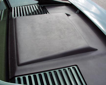

I'm sure ya'l are tired of seeing this but...
I have molded mine on and even painted it with NO CRACKS. besides you can always put a strut on there so no "slaming" happens.
I will look around for some "top" pics of the scoop. I would cut those tabs off there though.

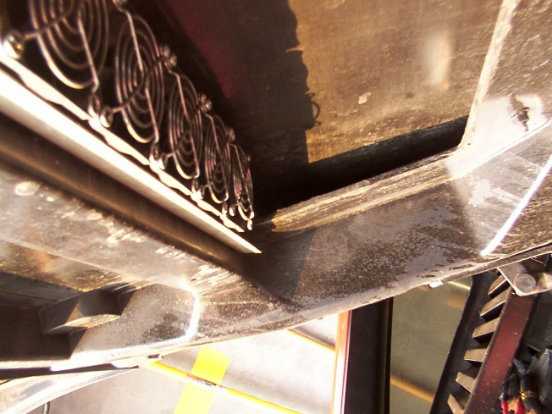

the fans (6 of them) are mounted under my stang scoop to aid in exhausting the hot air from the eng. compartment. I have a switch on the dash to turn them on or off. I usally leave them off till eng. is up to temp then switch them on to help circulate the heated air.(remember heat rises) so hot air hits the underside of the trunk, where they are mounted and out goes the bad air! They work VERY well!
I was just giving nos some ideas for the "final" product he is about to begin. I forgot to mention that when (or if) you add it to the trunk that you fabricate a center piece for the middle of the scoop opening for support since there is no "bolt" or anything to keep the center from drooping down in time.
Minn did you support the center??? Had any problems??
I believe my scoop is a bigger stang scoop than the ones pictured. it fit the trunk lines VERY WELL. seems like ya'll have a little bit of a lip from the "hump" to the scoop. mine molded right in with no little hump there. hummmmm
Thats what I thought I saw there, how 'bout a little more information on the fans? Where'd you get 'em, how much, how'd you mount 'em? Thats pretty sweet
The fans are from a computer AND 12V to boot! I mounted them on a piece of alum.angle iron.(found at Home depot ) Then screwed the bracket to the trunk "cross-brace" with two screws, at the end of the cut opening for the scoop. Connected them all together in series, and ran the wires to the dash via switch.
The fans are small and fit right up in the scoop. no problem in hitting the blower or the stock fiero intake.
Very cheap and easy to do!!!

I kinda of figure those were CPU fans (re; as I built PCs'on the side). Anyway that was very creative in your part!
Look more like case fans or power supply fans to me, not CPU fans.

The scoop it self does have the bolts in there(see fan pic) I did bolt mine down (5 bolts) BUT I also sanded down the deck lid around the foot print of where the scoop would sit.
Then a nice amount of bondo(with the glass "hairs" in it) on that footprint area and then smoothed that part out around the outer edges. then just worked on it till smooth.
**A side note, All this was done with the deck off. duh
