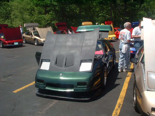

Well, I happen to have two "cool /cooling" scoops/vents on my car now:
I have The Fibersmith's 'stang-style deck scoop (installed right before this year's Dells Run)
On the bottom side, I just cut out the ocatagonal shape from directly above the engine. I always felt that my 3.1L was a bit "warm" - and the deck scoop does seem to have helped some. It's not extremely dramatic (the opening on the back side is only about 2" x 24"). If I feel I want further cooling, I'll probably install small electric fans below the Stock Engine "Vents" next to the decklid.
On my front end, I've got Rockcrawl's "JL Extractor" hood vent. It allows incoming air to flow out above/behind the radiator- it improves airflow, keeps headlights from popping up, and just simply looks cool!
It serves the same function as the ZR1-style hood scoops as well.
I don't have any exact measurements on how much it's reduced the temp on the engine (the needle fell of my temp gauge & I haven't fixed it yet).

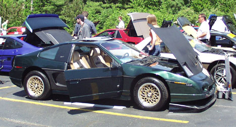

ls3mach- I did just happen to have a spare GT Decklid & Hood (my old hood was damaged anyway). But I could've used the original just as well (they're exactly the same-just different colors).
I just shot these out in the parking lot... so the car is a bit dirty.
Here you can see the shape cutout (there is still some finishing to be done). Once it's completed & smoothed, I'll get a small black hose- slit one side, and stick it around the opening to give it a more "finished" appearance.
And a couple of exterior shots from other angles:
Revin- I'll let you know... I'm not really planning on needing the fans yet. But I'll let you know if I do!

Oh yeah- guess I forgot that part The scoop is a Ferrari_Momo/Fibersmith scoop from http://www.fibersmith.net
I cut the corners & short edges with a rotozip (sabre-cutting bit), then actually cut the long sides with a standard 8" circular saw (faster, cleaner, and straighter than the rotozip). I then glued & clamped on the scoop (after checking & rechecking it's position). After letting it cure, I filled the edges with bondo- a few coats- simply using my pointer finger to get the smoothed curved edge. There is still some final sanding to be completed, but it's certainly good enough to have on the car!

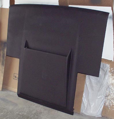

I have a factory mustang scoop that the one MinnGreenGT has on his car was pattern after.
It is listed on my website. I will include shipping at the price listed. It has mounting studs. (By the way MinnGreenGT, you did a great job on that install !!!)
