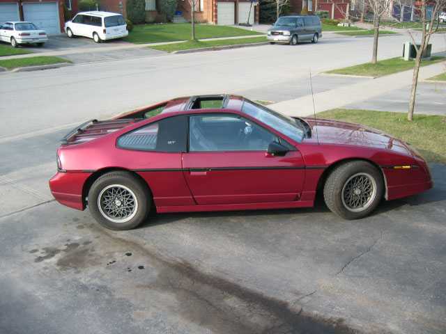

Ok I've been starting to wonder, does my paint job have pearl in it? I'm asking for those expert opinions on it. It was tonight that I looked at the car when the sun was heading down and the way it just shined nicely in the sun made me think. This pic is probably the best recreation of what I think I was seeing today. Experts???

since when did fastbacks come with lugauge racks?!

LMAO, believe me, I've only seen 2 other cars with it. No one has been able to figure out really how rare it is. I'm thinking it was a dealer option. I guess they didn't want a wing but wanted extra storage capacity? I think it looks good and unique.

not going to be able to tell from a photo. You have to see it under direct light or sunlight to tell. It looks like a OEM color, so Id guess its not unless someone added it during a repaint.

Its close to an OEM colour, but put it next to a stock 87GT and you can clearly tell a difference. It has been repainted (obvious by the lack of silver on the ground effects). I have no clue though because I was not the owner who painted it this colour.

FieroMunk:
Actually, the more I look at your car's pic, the more it looks like it could actually be a pearl color. Seems like it has a certain sheen there that aren't present in other pictures, especially by the way the color looks around the specular highlights. One thing's for sure, it doesn't look like a flat paint color.

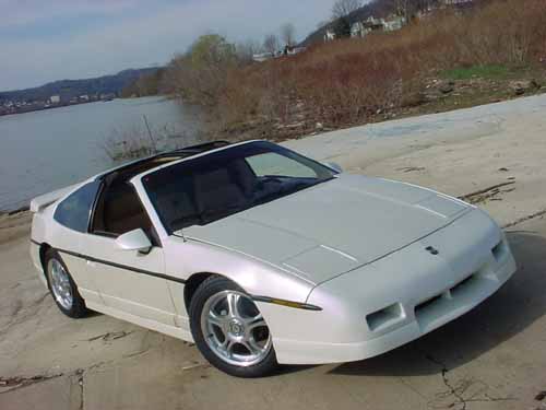

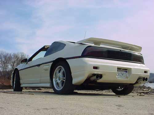

Doug Kinney's (Fiero Warehouse) Pearl 86

Originally posted by Reality:
Oh man, I LOVE that color! From previous descriptions, it sounded like a pearl white wouldn't look so hot, but that looks great!
