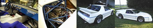

Kind'a off the battery thing, but along the lines of a fire system. A suggestion for your serious performance cars. I installed an onboard fire system. 10 lb. Fire Bottle in the racecar. I know it is overkill, but how much is your life worth? For a street setup, a 5 lb would work for the engine compartment. A much better system than "oh my gosh, there's a fire!... where is the extinguisher!?.... found it.... (spray)". $300 bucks and the fire can be (most likely) contained without taking the time to get close to the fire.
Not practical for all, but a substantial option. Just my 0.02
