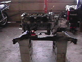

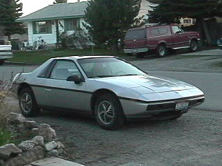

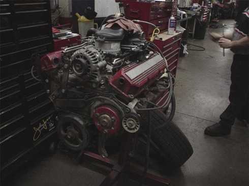

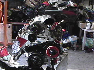

hi guy and gals i finnaly got time to start on my swap if u havent read before i have a 88 formula i will be putting a 91 4.9 caddy in it here is a pic of the car
after i got out the motor it looks like it has been rebiult
that is after i got it striped down and i cleaned it up a bit now i am wateing on my gasket set from felt pro but i didnt know it would cost over 200 dollars for a gasket set oh well
now i set my sight on the mounts i started to strip the cradle and clean and get the suspention ready for poly
to day i went to pull and savepulled and bought my fly wheel and new exaust manifold because mine had a big dent in it that is about as far as i am going to go today i will keep posting untill it is done and i am sorry for my bad spelling

Looking good! I too could not believe the prices they want for gaskets on this mtr. I priced out a complete upper and lower end rebuilt kit and it was close to $1000.00
Keep up the pics and the progress reports. ehh

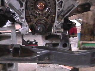

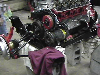

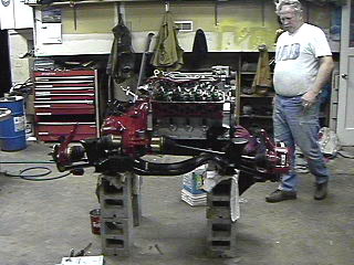

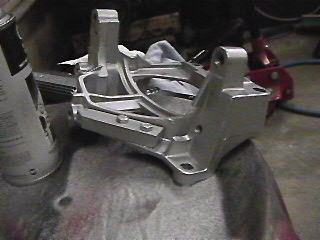

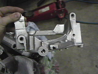

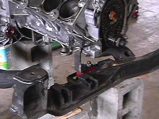

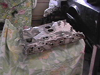

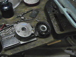

ok well i had time to work on my car and i got around to buliding my mounts here are some pics
here is the front one
later to day i am goint to start preping the motor for paint and order my tranny mounts from west coast and some outher little things.

Report this Post04-03-2003 02:03 PM Click Here to See the Profile for FierokingClick Here to visit Fieroking's HomePageSend a Private Message to FierokingDirect Link to This Post

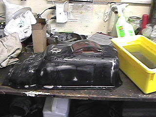

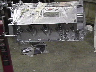

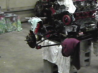

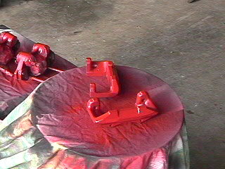

i gots some time to work on my car

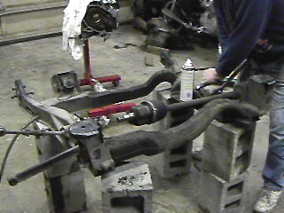

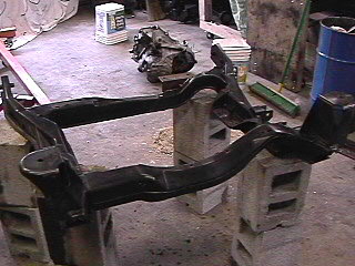

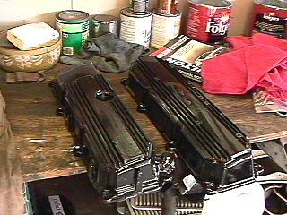

i cleaned up the cradle it is ready for paint

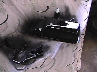

i had to do some wet sanding on the oil pan the paint got all messed up
got paint to finnaly look good

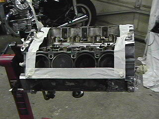

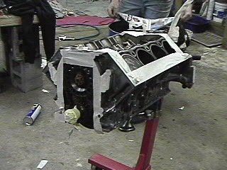

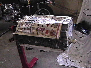

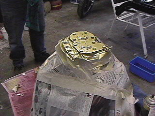

my dad started to mask off the motor for paint

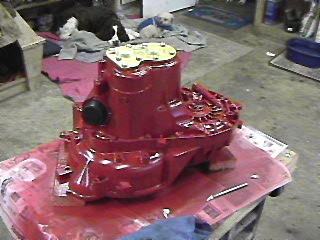

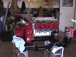

my dad got it all done and put a few layers of paint on

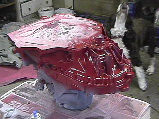

tranny all ready for paint

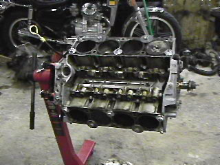

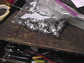

while paint was drying i cleaned up the injectors and rail today i took my heads to the shop for new seals let me tell u working for 11 hrs will take a toll on u

Looking good! I just finished rebuilding my 4.9 and it is alot of work. I went alittle different rout. I bought an 86se 4 banger with a blown engine so I could take its engine cradle out and build my swap on it. When its ready to go I'll put it into my 87GT and then put the good V-6 into the se and sell it for alittle profit. I'm also going carb, just for ease of instalation. Did you go with Joe's mounts or your own design?
Seems like this swap is getting more popular all the time
Keep us posted

CRZYONE.. from the pics it looks like those are Joes mounts. Then again he said building the mounts. Hmm Look the same as the ones I'm using..

ok i guess nobody hates me the mounts are like joes but i made them so i guess they are a hybrid mounts. as for wiring i dont think it will be that hard but when the time comes i guess i will find out. i will be working on it in about 10 min and will post more pics. any one got any pics of parts done by jet hot because i am thinking about haveing it done

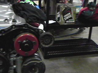

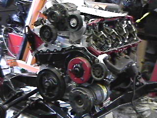

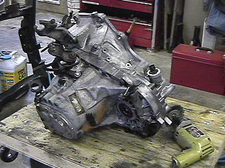

ok i finnaly have time to post some pics

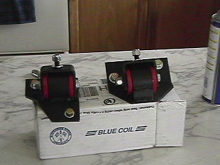

got my tranny mounts from west coast thanks guys !!

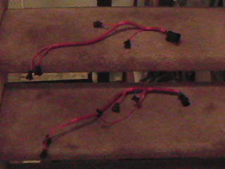

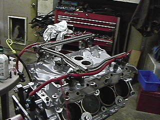

had time to re-do my fuel rail injector wiring harrness
started to paint my tranny
here it is i dont really want to put it in my car now it is so darn pretty
all i need now is my heads back from the shop and i can put the motor back togher and i need my fly wheel plugged and redrilled. i also got my prothane in so i do that

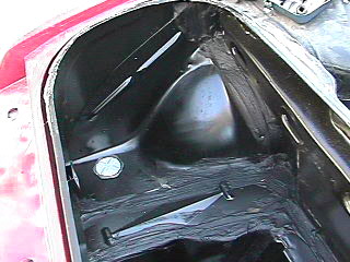

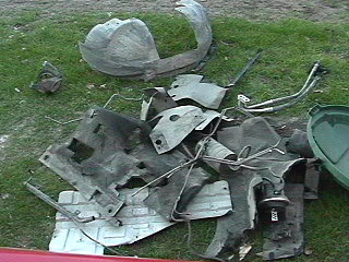

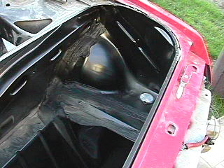

Well it was a nice day to work on the car so i started to clean the engine bay
i didnt know this much stuff would come out of such a small area
This is why i love living in the nothwest

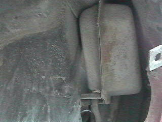

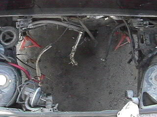

dose any one know waht this is 2 lines run in to it. it is on the pass side and can i remove it because i am doing a v8 swap

RBeaubien
Posts: 775
From: Glendale (Phoenix), AZ, USA
Total ratings: 50
Report this Post04-10-2003 03:34 AM Click Here to See the Profile for RBeaubienClick Here to visit RBeaubien's HomePageSend a Private Message to RBeaubienDirect Link to This Post
Some guys have removed that tank. I wouldn't. It is the expansion tank for the fuel tank. It guarantees there is available space for the fuel to expand to when it gets hot and the tank is totally full. The design of the Fiero tank allows the tank to be totally filled where most cars have a dome to prevent the tank from being totally filled. It needs air to be able to compress when the fuel expands.

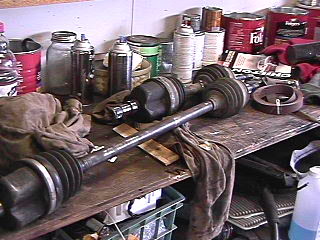

i had some more time to work

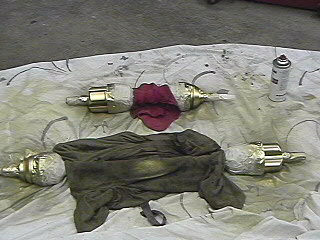

got my injectors back inj the rail

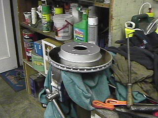

painted my rear brakes
getting the half shafts ready for paint
i will try and work on it more after dinner and tommrow. and i have one question Why dont u guys like my work i see that crazyone is dont the same thing and every body post asking him questions and giving him props and not very many peeps do it for me why not ??

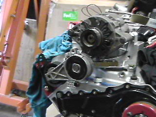

Looking good! Just a little tip go to the junk yard and get another front valve cover for the rear. Why I say this is that if you install the rear cover on the engine and install the engine it will hit the hing on the pass. side firewall. If you look at your front cover it has a corner that is lower on one side, with that on the back it will clear the hing and you won't need to cut the lower part of the hing off. I just did this on one of are club members 4.9 that he's installing into a 88 fiero.

I like, nice pics. The standard flywheel looks just at home on the 4.9

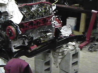

Report this Post04-26-2003 10:52 PM Click Here to See the Profile for FierokingClick Here to visit Fieroking's HomePageSend a Private Message to FierokingDirect Link to This Post
i have all most all of the suspention done and brakes i still need to paint the sway bar. right now my dad is making a bracket for the idler pully

PBJ
Posts: 4167
From: London, On., Canada
Total ratings: 147
Report this Post04-26-2003 11:01 PM Click Here to See the Profile for PBJSend a Private Message to PBJDirect Link to This Post
I used the hole beside the waterpump, made a spacer to fit flush with irregular casting and has worked well. Some even have tensioners on the now too.

Hey Guys My dad and i have not really been working on my car but today me and my dad got some stuff done.
This was our first idea for a idler pully but it didnt do what we wanted.
We liked this idea better now we need to get a belt and we will be in busness.
Started to work one the wiring harrness.
Their really insnt much stuff left to do before i can drive it but i still need to paint the engine bay i was thinking a nice shade of PINK would do
But really would a copple coats of gloss black look good or should i go por 15.
Thanks

Oh i all most forgot to answer Red85GT's question i picked the 4.9 swap because of money (yea right) and because the motor bolts right up to the tranny. And it weighs less then the 2.8

What tensioner did you end up using and do you have any better pics and a p/n #? I like yours much better then the Fiero Factory set up.

Hey i got some better pics on how my dad made it
He added a pice on metal to stop the back of the pully from swing around.
It mounts on the bottom hole were the stock wheel was my dad shaved a 1/8th of a inch off to get it to line up.
As for this umm we went to pull and save and got it but it was on a GM early 90's v6 motors i will try and figure out witch car it was off of.
This is to try an get more belt on the altentor but i dont really know what that is from either.

Thanks, it looks good. I wll give it a try.
