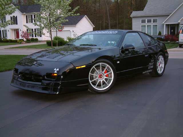

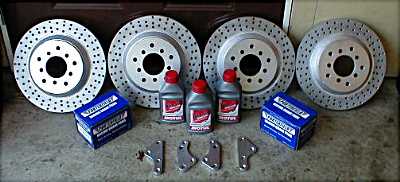

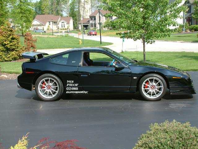

Installed pics and my personal opinion on it will be coming soon....
F.Y.I it is 12" cross-drilled Corvette C-4 rotors, Porterfield R4-S compound pads and Motul DOT 5.1 brake fluid....total cost to me...$690

Yes, the brackets are from WCF. I will be using stock calipers. I have two brand new calipers on the front and just recently rebuilt the rears.
I did do some upgrades to the calipers as well. I took all of them apart, polished all of the pistons and bores, and did the same thing with all of the sliders, so the calipers are the best they are going to be. I am also painting the iron part of the calipers red so it will have a porsche look to it when it's done..

Did they sell you just the brackets, or did you get the rotors from them as well?

I actually bought the whole kit from Azrael on the forum.
