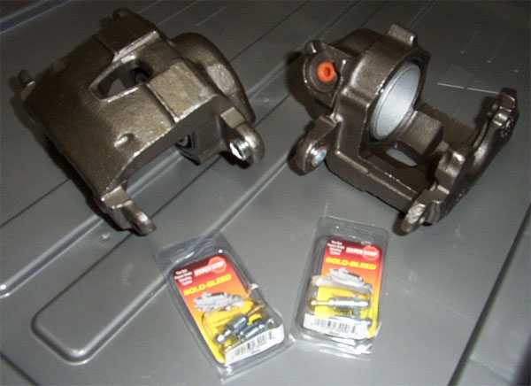

I weighed the set I bought today with a cheepy fish scale. Each one comes in at a whopping 6 pounds. It would be nice if someone posted the weight of a Stock Fiero front caliper and the aluminum 1le capliper.
The new set, ready for powdercoating, sitting with a set of speedbleeders.
Good Luck guys
Archie
Posts: 9436
From: Las Vegas, NV
Registered: Dec 1999
Total ratings: 547
Report this Post02-04-2003 08:00 PM Click Here to See the Profile for ArchieClick Here to visit Archie's HomePageSend a Private Message to ArchieDirect Link to This Post
I'd suggest that you remove the pistons and rubber parts from thos calipers b4 the powdercoating.
Archie
Thanks for the suggestion. I'm still considering painting vs. Powder Coating. I wonder about that Por-15 product, Chesters been using.
I plan on borrowing an accurate scale from work to do the comparison, but if Archie is doing as well it doesn't really matter.

Accurate weight: 2995g or 6.6028369 pounds
This was done on a digital scale with the bleeder screw in.

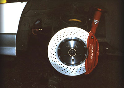

One of the things that really gets me about the forum in general is all the experts who have NEVER experienced what they are preaching about.
As for loss of cornering ability..none ..not a thing. The weight increase is minimal , I never even saw a loss in performance (acceleration) as for high speed stability ..IT"S BETTER.. Depending on how you set them up fiero's can be twitchy at high speeds. I have taken my car into triple digits many times (more than I could count) with the new brakes the car feels as though it's planted at higher speeds, something that is hard to say with ANY stock Fiero. Other than vastly increased braking ability the main thing I noticed was the stability at high speeds. It feels more like a vette and less like a chevette. I don't get to drive my car a lot , but when I do it's usually on the track or on long trips where triple digit speeds are often seen. It's hard to explain ..the car just feels much more solid at speed.
Of course were going to get the know it alls on here with their calculations as to weight increase vs. performance. These are the same guys who just read and regurgitate everything they get there hands on with no real world experience. There also the same guys with cars in the garage in 10 million peices who fatisize about beating Mclarens.
So in retrospect...
Once you get thebrakes , you will agree that it is just what the car needed. Be it a 2M4 or a 400hp 383. You can drive with a much greater level of confidence.
