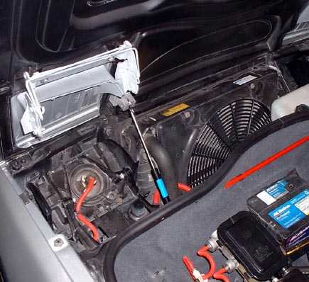

I've been playing around with this idea for awhile, I know other poeple have done it but I don't think anybody is selling them.
These are just pictures of the protype I made, the finished parts may be slightly different(I have already made changes). It uses one gas strut, all the other parts are made of t-6 aluminum(could be painted or polished) Two holes would need to be drilled for the lower mount, while the upper mount uses the two bolts in the hood hinge.
The strut I used is strong enough to easily hold the hood up, but when it's closed there is no upward push on the hood. The strut dosen't start to push until the hood is about half way up, then it opens the rest on it's own.
Price would depend on how many people are intrested, probably $50-75
Any thoughts or questions just ask.

I have another question. Where does the lower support mount to?

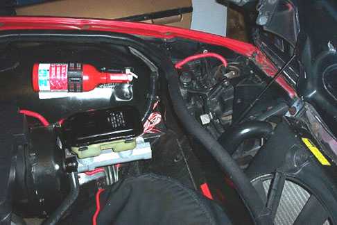

If you've worked out the "strut push up" let me know how, i did this last year, but i don't like that when the hood is closed, the strut pushes the hood up on the corner, it just looks bad. Thanks

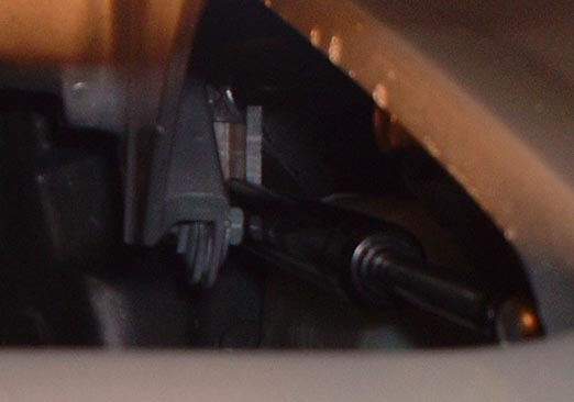

The pic above shows where the lover mount sits, this is an old picture I have made the mount longer so it can be bolted on easier.
Currently I don't plan on making a dual strut system, the radiator reservoir would need to be moved.
qwikgta- From the looks of the picture you posted, the reason your strut was always pushing up is beacause you bolted the strut directly to the hood bolt. Mine bolts closer to the hinge's pivot point. Plus I bolted the strut to a block which sticks down lower when the hood is closed, it still pushes up but not enough to move the hinge.

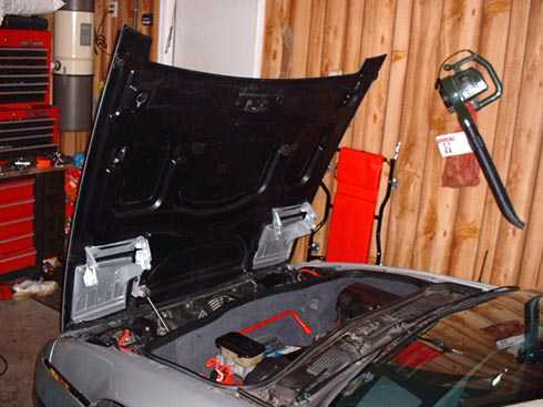

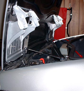

Here it is Dual struts.
Unlike my previous designs I mounted the strut up higher on the panel by the headlight bolts. This creates a very shallow angle, so when the hood is closed the strut is pushing parallel with the hood thus no chance of the hood bowing.
The only problem I found is the hood hinges can be off-center from the rest of the car. This create's a big problem when trying to squeez a gas strut between the radatior reservoir and the headlight door.
In the pic above you can see how close the strut comes to the bolt on the headlight door.(I only had clearance problems on one side, the other side I had ton's of clearance) It took some trial and error but I finnaly got it to work.
This will be my final design, A single strut will easily hold up a stock hood and probalby most of the modified hoods. With dual strut's having the balanced look and able hold up just about anything, yet when they close no pressure on the hood.
If there is any interest in this design LMK and I'll work out the details. I would rather just sell the required mounts and have the buyer purchace the struts. This would keep my cost down and the mounts would be cheaper.
