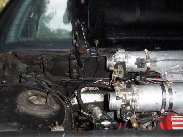

I used the primary throttle body to run the IAC tube to. I just cut the metal iac tube and put a piece of rubber hose between the two pieces that was long enough to reach the throttle body.

It is not so much the 2 throttle bodies, but the lack of restriction to higher RPM's from the long runner Fiero intake. It was an experiment and a successful one.

Shaun, I don't see anywhere that equalizes the two tubes. What I mean is that both sides should probably be connected somewhere after the TB's to negate any possible flow inequalities from air filter plumbing, etc.
It will be interesting to see how smoothly it runs once you clean it out.
