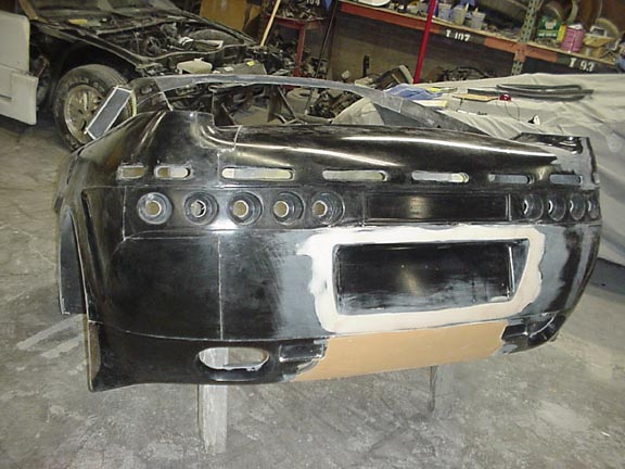

Report this Post02-28-2002 11:14 PM Click Here to See the Profile for ArchieClick Here to visit Archie's HomePageSend a Private Message to ArchieDirect Link to This Post

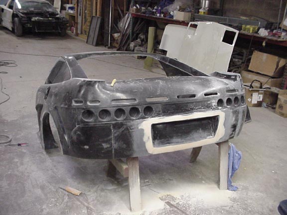

Well this color thing has me real messed up. Since I can't make up my mind 'cuz I got no clue anymore, I'm gonna do what rgeeinc suggested and leave it up to my help to pick from the colors you all have suggested.
AS this has been going on we have been making limited progress on the Fino. One of my guys has been out sick all week, so it's been just me and Rob (mostly Rob) working on the car part time this week.
Maybe we can't decide on color, but we can put it together just fine.
So let me bring you up to speed.

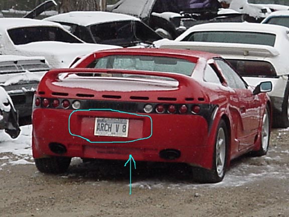

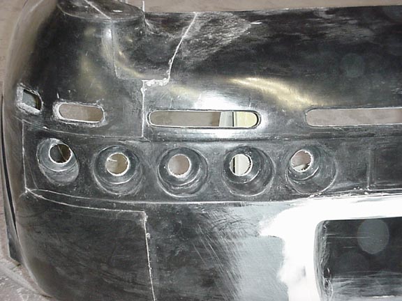

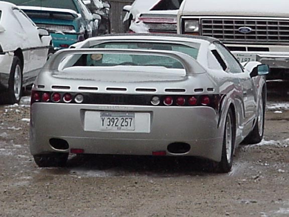

You'll recall that we had completely trial fitted the body to the chassis. So now we are taking it apart and cutting out the vents, holes etc.
First thing we are going to do is the rear clip. In the area where the plates will mount you have several options. The body starts out not having this plate mounting area (blue circle) it is a seperate piece that comes with the kit. Also the lower Facia come with a plate mounting area incorporated into it(blue area). Many people like the body style where the whole area under the taillights is uninterrupted by the "plate pocket" & they just mount the plate in the lower facia.
Others' opt to install the plate pocket and leave the other plate mounting area in the rear facia like it is in the picture above.
OR, you can mount the plate pocket and Glass in the plate mount area in the lower facia Similar to this.
We are going to do it like it is on the Silver car above.

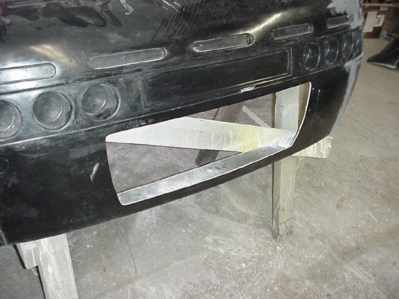

We pull the rear clip off the car and do most of the work off the car. Most of this can be done on the car but we like to do it like this.
Here we've cut the hole for the plate pocket.
Here we have glassed in the pocket. It was glassed from the back and filled from the outside. Details of this are in our Instruction Video tape.
Here we have cut out the vent slots and we have the tail light openings ready for the tail lights. Details are in the Video instructions. The beauty of working with Fiberglass panels is that you can easily change the cars' configuration. If you think a certain tail light would suit you better you can craft it in very easily. If you want to you can fill in the vent slots (these slots are for looks only, I assure you there is plenty ventillation without them. The nice thing about building a body style of unique design (as opposed to a replica) is that you can make lots of changes without later having someone tell you that your idea of what looks good "is not true to the original".
This picture shows the rear clip with the modified facia trial mounted to it. Some sanding and finishing are yet to be done on the facia.
More to come.

Archie,
How about adding some red lights to the slots in the back? like for brake or running lights?
lol Maybe make them go back and forth like "kit" on knight rider!!

I at one time thought about doing something sweet for the lights.. the tail lights that is.. I'll email you about it Archie, it would retain the same tail light config but... it would add a twist and put you back in the loop again with another 'first' in fiero history...not that you need any help of course!
I'll see if I can't get a few sketches on the computer to give you the idea and works of the lights system.

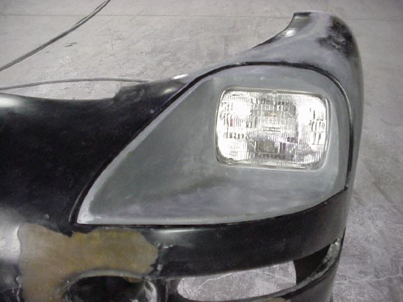

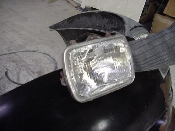

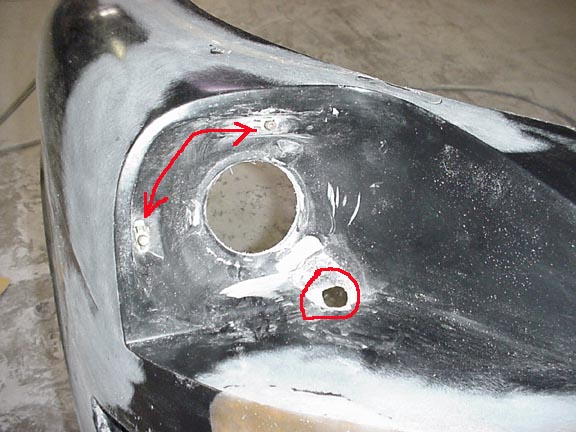

Tonight we cover the mounting of the headlights, parking lights and the door handles.

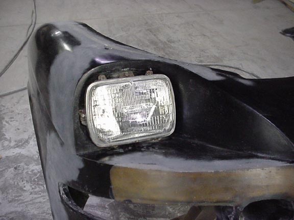

Here we have finished the drivers side headlight mounting to show you what our goal today is. Notice that we are using a Gray headlight surround to make it a little easier to see.

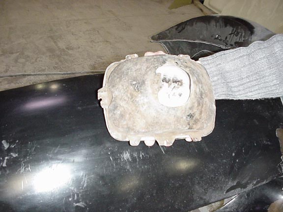

From the original Fiero we use the headlight, headlight trim ring, adjusters
and the metal bucket that the headlight sits in.
We use a hole saw to cut out the hole (marked in the FGlass) to clear the plug in the back of the headlight. We also trim square holes to mount the headlight adjusters. (red arrows) And we put in a hole to accomidate the headlight mounting spring. (red circle).
The headlight fits right into the packet, just like this.
Trim and fit the trim ring according to the Video Instructions and it looks like this.

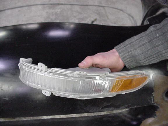

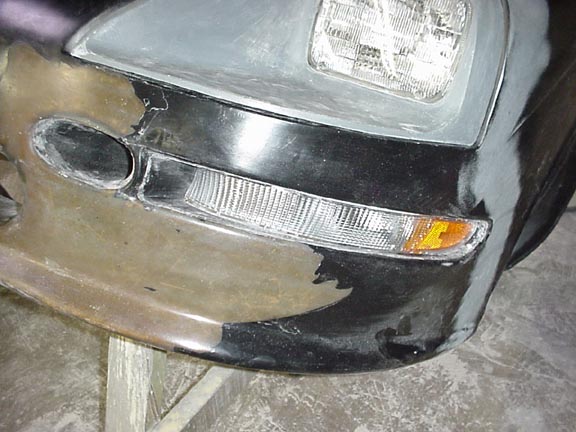

The parking lights also come with the kit and are pretty easy to fit to the inside of the front clip. The light looks like this
And Slips into the pocket from the back side. You can either glue it in or make up some simple brackets to mount it. We prefer to glue it in with something like 3M Windoweld.
There is not much else I can say about the parking lights they mount in real simple and you move on.

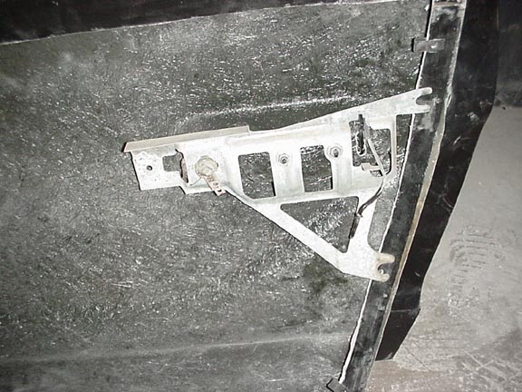

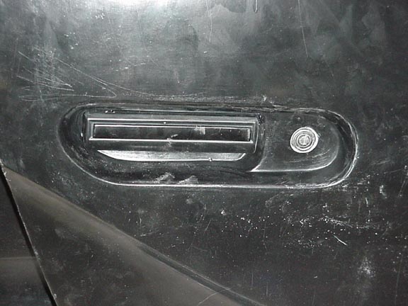

We move on to the door handles.
The Door handle mountings are covered in detail in the Video Instruction tape.
As you can see all the original Fiero door handle parts are mounted to the new fiberglass door skin just as they were mounted to the old doof skin. You have to drill a couple of holes in the new door skin and open up a slot, then bolt it on.
Archie
