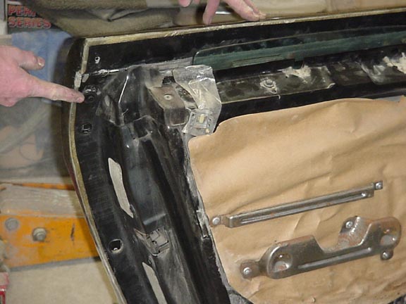

Here the door skin is loosely mounted, you can see how much of it sticks out behind the trailing edge of the door frame.
Now that we have the door panels on the door frames, it's time to see just how easily the rear clip mounts. Our Video tape shows live action of us actually putting the rear clip on the car. Until you see that video you have to take my word for it that it is real easy to handle and align. We will bring the rear clip forward enough that the forward section of the roof tucks right underneath the remaining Fiero foreward roof panel (see arrow). In the areas that are being pointed too, you can see how far forward the rear clip fits.

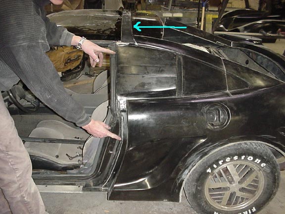

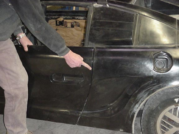

When we close the doors we can see just how close we are in the alignment of the rear of the door panel. After moving the door panel and the rear clip around for just a little bit we come up with a good seam line and carefully open the door and snug up the bolts that were left loose for adjust ment. The Video Instruction tape details the easy method we have to make this door gap perfect from the get go.

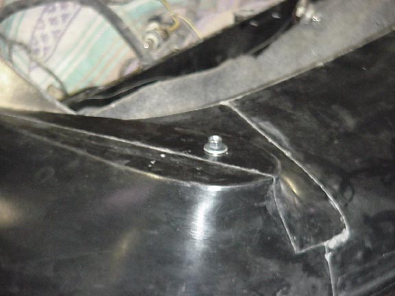

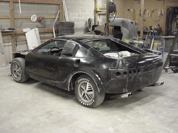

Remember those triangular shaped parts we installed just a little bit ago? Here they are as the rear clip is mounted down over them. When the rear wing is installed it will cover these bolts.

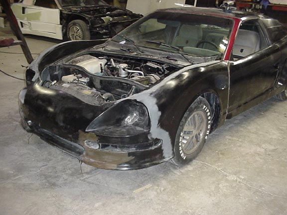

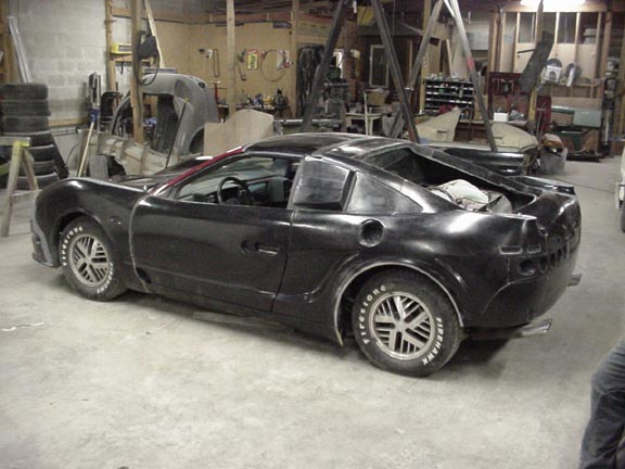

Now the car is taking shape. It's time to mount the front clip to the chassis.
Here the front clip is setup on the chassis to look for any possible areas to be trimmed. The original Fiero Fender bolts are used in the same places to hold the top areas of the fenders just as before. You have to drill holes through the Fglass for these bolts to pass thru.
More yet

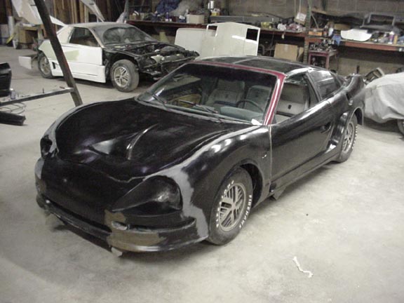

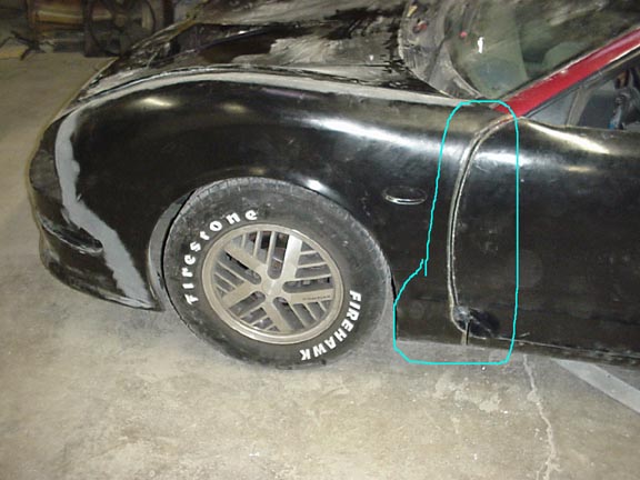

Now we get busy aligning the fender gap with the front of the Fino front door edge. This is real easy to get exactly right in adjustment. Do a little thinking right here while installing and save lots of time.

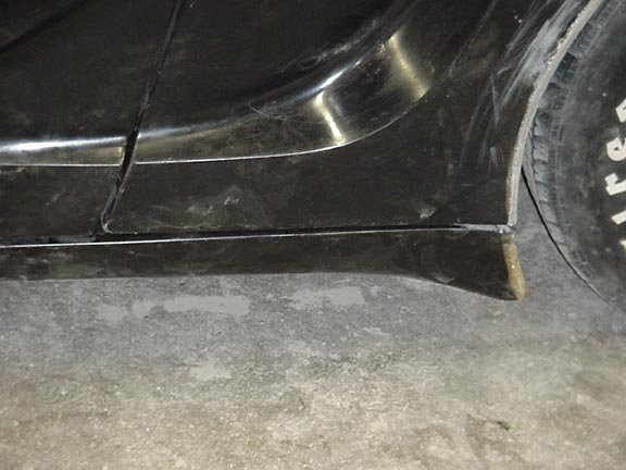

The video details the mounting of the rocker panel and your mounting options. This is the view of the rear part of the rocker panel. At this time it is held on by 2 hand squeeze claps and a pair of Vise-grips.
Here the hood is being test fitted to the car, the original Fiero hood hinges, hood prop & latch parts are used and will bolt right onto the new hood.
Well, it's already looking like a different car…….. 5pm time to go home, Monday night.
