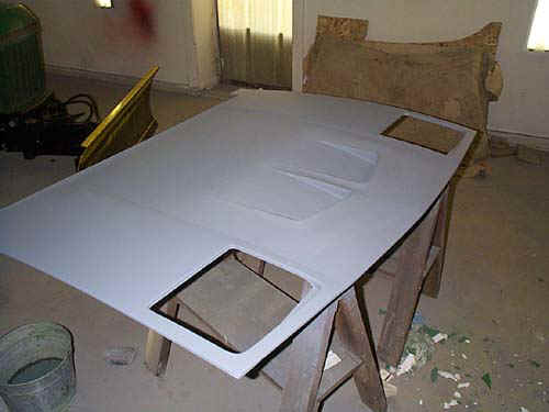

You want to extract the air exiting the radiator, so the farther back from th efront edge, the more effective it will be.
As far as cutting the lip into the tire well area, I don't know about this, so I will not venture any farther than say A) that area already has drain holes, and B) all that stuff in there is exposed to the elements in 99% of all other vehicles on the road.

Hey Cozmos, why didn't you call me iof you were having problems. I would have told you how to correct them. As far as cracking there will be none if you put fiberglass tape about one inch wide around all the edges.
I have installed several and have had no problems.
For those of you who do not know this, but my hood vents are functional at a low speed of 12 miles an hour and at 125 miles an hour my front end did not feel light and the headlight doors never came up. In fact driving at 125 my car felt like I was doing 85

why don't you guys just put the vents closer to the front of the hood, so you don't have to cut the trunk lip?
The problem is that if you move the hood vent too far forward, it interferes with the radiator shroud. And besides, having the opening for the vent above the radiator shroud instead of behind it will not be very helpful.
For the better part of a year, I had hood vents on my 86 coupe. But they weren't the recessed vents like the ones in the pics up there. These were low-profile scoops turned backwards. Yes, even on my mostly-stock 4-banger my coolant temps averaged about 10F degrees cooler. And the car was more manageable at highway speeds (thanks to increased front downforce). And I also found a third unexpected plus... the hot air coming out of the hood and washing over the windshield acted as a great window defogger.
