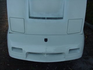

Well.. My scoop is on the way.. Its the same type that Oreif has on his car. (I think mine will be a little larger) I'm throwing it on a silver '85.
Oreif's Photos

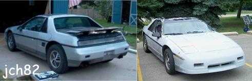

I have Pat's ZR-1 hood scoop coming. It should be here in the next few days!! When I get it on, I will definitely post some pics...For those that don't know what it looks like, you can see it at www.thefibersmith.com

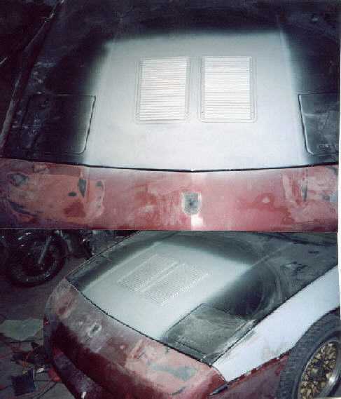

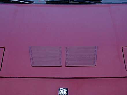

these are from a K car.I can't remember which one.

Dan, I saw those on a turbo lebaron the other day on the sides...... I knew I saw those someplace before.

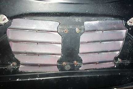

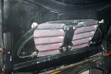

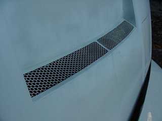

Here's some pics of my recently completed hood vent...
Yes, that IS a dash vent grill
I cut the hood with a skill saw with a 24 TPI blade. Used 3M flexible epoxy to hold it all together. I had to trim about 1-1/2" off the lip of the spare tire well. This is a pretty easy mod to do, it's impractical to ship a hood so I don't think it would make a viable product.
I didn't notice any reduction in engine temp., but the grill gets plenty hot after some spirited driving...
