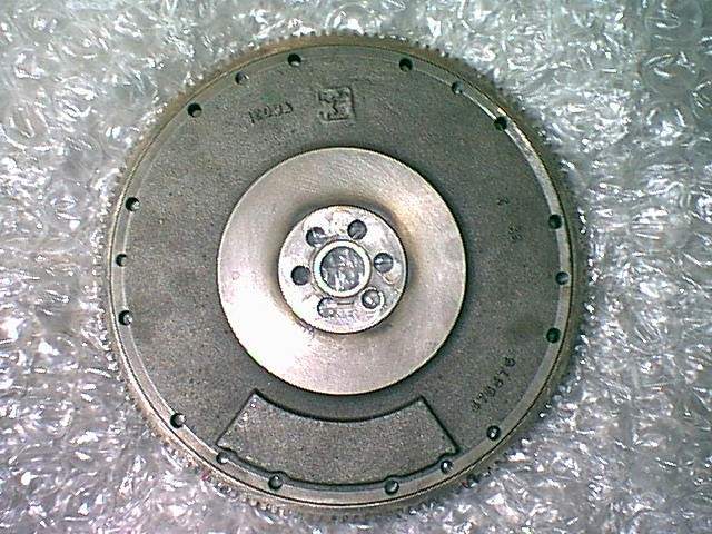

Here is the casting number for the flywheel: 476575 29J 12021
I hope this can help in some way for you to figure out what could have happened. It’s great to see that you are willing to help to find the problem. One problem, and it’s a big one, too late for me, but hopefully in the future others will be more educated on what things can go wrong with a swap.
I must have taken the wrong steps in my install:
1) Rebuild engine and have someone “match balance” a flywheel for me. If the flywheel was match balanced, then there should be no problem with balancing. Ok maybe there will be a little off balance.
2) Install everything after a lot of planning and hard work
3) Start up for the first time and notice that indeed there is a problem. Should the steering wheel jump up and down? I don’t think so, using stock Fiero rubber mounts.
4) Go through the process of debugging everything and finally have it all ironed out, except for that damn shaking. Now my headlight doors are dancing at idle.
5) Ok, the problem is getting worse. I’m now planning on removing the setup at the end of the week.
6) Next day, oil leak, and not just a little one. Damage has been done 
7) Rip everything out again and start taking a look at what happened.
8) Now time to make some calls. I felt like I was treated like an idiot on the phone at first. Blame is trying to be placed elsewhere when my question was how the flywheel was balanced because it doesn’t look like it was, nor does it operate like it was. I was curious to know how this process worked and if it was possible that it was never balanced. The only reason I thought this was because of emails sent in the past that didn’t go well with one another. One week the flywheel was getting balanced the other it had to be sent out to be balanced. This made me feel uncomfortable. Well guess what, I honestly don’t think it was done. Sure, WCF offered for me to send it back to look at to see what is going on. I was told that Chris will personally go to the balancer’s place to make sure that they are running the balancing machine correctly, and if they are not, that they should not be running the machine. I think that was very nice to offer that option to me, but at this time, I can’t send it back out and wait.
As far as the fixing of this problem, I will be having the flywheel balanced a second time with the whole engine assembly, the way it should be done as I am told. The question remains, what are all those guys going to do who buy brand new crate engines and rely on WCF’s modified flywheel. Are they going to have to pull the internals out to verify the balance of the flywheel? I know that question is a bit far-fetched, but seriously, I was under the impression that it was a match balance. Especially since it was sent with the flexplate to be matched to. There is also that clearance problem I had. Does anyone know about such a problem with this configuration? WCF, do you know about it, would be good to mention that so others don’t have this expensive problem. Here’s a pic of the match balanced flywheel, see for yourself, either the stock unbalanced 2.8 flywheel was a direct match to the flexplate, or it wasn’t done. Maybe the counterweights where just matched up between the flexplate and flywheel and that is as far as it goes.
I don’t know what else to say to everyone, but my lesson learned is to ask a lot of questions before jumping into something. I don’t flame anyone, nor do I want to on here, just getting facts across.
Here’s the flywheel, take a look

sorry bout that - just getting back into the shop at 1:37 pm on Wednesday afternoon. What I am going to do is run this part number through my sources and learn everything about the 95 engine that I can - perhaps there is something that we both missed

It's not for a 95 engine, it's for a 1990. see what you can find out, it's good to know so down the road things like this don't happen.

So anyone know what to do to solve this interference problem? How thin can I go with the flywheel? I have time to figure it out since I have to locate another Getrag trans. West Coast Fiero, can you help out with this, or give some suggestions. After reading the posts from a previous problem just like this one, you seem to know about it. If any oney knows the solution, you should.

Why is there concern for what engine it is. The flywheel was to be match balanced to the flexplate I sent you.

How did your shop balance the engine? Was it switched from externally balanced to internally or vice versa? Or was the weights drilled out of the crank and re-fabbed for a neutral balance?

The way the machine shop balanced it was that they made up bob weights for the assembly. They matched the ballance of all pistons, weighed the rings and connecting rods. With that done they had bob weights attatched to the crank with the harmonic ballancer and the extra flexplate. As far as they knew, it was the flywheel/flexplate for the engine (flexplate was not modified, they drilled holes in the big piece of metal on the crank). I didn't mention the modified flywheel from you since you where to match balance it to the original flexplate.

Why are you guys jumping Eric_Pa for continuing to post here? His last response was a response to question asked by WCF HERE.
I'm not sure some of you understand the issues involved here. Look at the picture of the flywheel, there is no evidence that it was balanced AT ALL. Go back to page one and read what rockcrawl wrote. I don't blame Eric_Pa for not wanting to send it back.

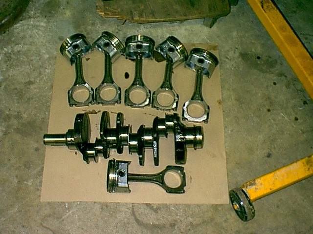

Now why I don't send the flywheel back at this time? Here's a pic of the engine in it's current state. Sine I was told it's a Hot Rodder NO NO by WCF to rebuild an engine with out the FLywheel, I will take his advice and do my rebuild a second time this year with his match balanced flywheel. Can't wait to see how dead they are on. By the looks of the flywheel who's pic i posted, I'm willing to bet it's way off. Nothing like a freshly rebuilt engine turn back down to this.
since the post was up ontop again, I couldn't resist

Hairy_Fiero
Posts: 795
Total ratings: 72
Report this Post01-27-2002 03:52 PM Click Here to See the Profile for Hairy_FieroSend a Private Message to Hairy_FieroDirect Link to This Post
Looks like 2 problems.. Which are very simple yet expensive. Both sides the buyer and the seller need to do. Buyer needs to do more research ask more questions. Seller needs to be be more informative, or include a disclaimer or advice with the product where it is advertised and when sold. I completely support West Coast Fiero and hope they continue to make fine products for our little cars...
