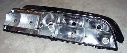

OK, there has been quite a bit of conversation about clear taillights for Coupes & GTs. Many people have already just removed the colored Lens and replaced their clear blubs- which is fine for them. But this seem unfinished to me- and looks rather cheap. I acquired a damaged GT taillight for experimentation (Don't worry, I wasn't using my "GOOD" ones)

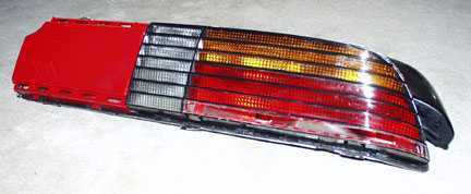

First off, Separating the inner & outer lens is simple. Just pull them apart (there are some clips on the sides). This is pretty much where everyone stops... they just remove the colored inner lens and replace the clear bulbs with colored ones.
The Outer Lens has been removed

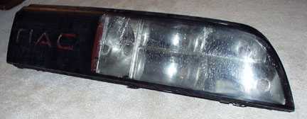

The Inner Lens has been removed
The Assembly with no inner lens... OK, but looks naked to me!

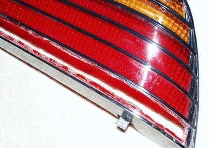

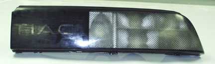

I Also plan on changing my "PONTIAC" to appear green by removing the red filter and replacing the white bulbs with green ones- or neon if necessary. I will also add a diffuser lens (see farther down) behind the "PONTIAC" so you don't see just the brigtness of the bulb.

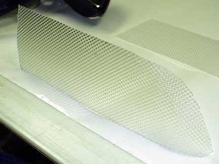

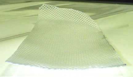

I have decided to mutilate the inner lens to try to make a new style. I have found that the original lens is very similiar in texture to that of an office ceiling tile light-lens (picked up a 2x4 sheet at Home Depot for about $3). -Which I will reference from here on as the "Diffuser Lens"
Diffuser Lens pattern from Home Depot.

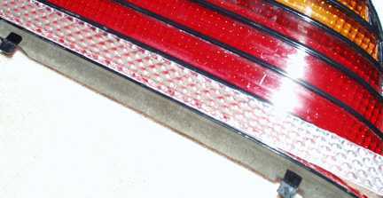

I then cut out the colored strips in the lens using a Dremel with a Fiberglass Reinforced cutting wheel. If anyone knows a better/cleaner way to cut this plastic... please let me know, 'cause this tends to melt the plastic before it cuts cleanly.
you can see in this photo how I have cut the inner lens.

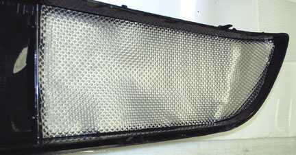

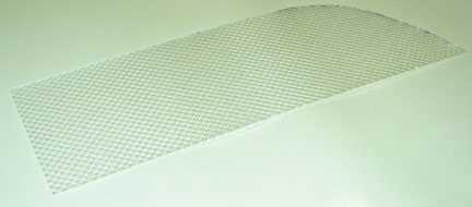

I then cut the diffuser lens into strips to fit the openings. I am planning on repainting the cut parts of the lens black, so that the old Amber & Red don't show through all the time. When they are all cut I'll replace the original bulbs with colored ones still, but you won't be staring straight at reflectors- and you'll still have a semi-stock appearance.
The diffuser placed on the cut opening- some heat might be helpful in bending the plastic.
My other thought- after photographing these... is to skip the cutting & gluing part, and to just shape the diffuser to fill the inside of the clear outer lens. This would probably be quicker, cleaner, easier, and look better in the end. I wil also place a piece of the diffuser behind the "PONTIAC" as mentioned above.

Tonights work was a success I think! I used a single piece of my "diffuser lens" to fill the space- much easier than cut & paste! A little patience when trimming (the stuff shatters if you're not careful) and a little time with a 400degree heat gun (and a pair of leather gloves)- and it looks cool. Of course I don't have a set of lights yet, but I'll post pics in the morning of what it currently looks like. And I'll definitely be bringing the sample to Fierorama for everyone to check out!

Ok, here's what I came up with:
I first cut a pattern using a large piece of paper. I then cut a rectangle the baisc size of the piece- and trimmed the arc (that's the tough part). You can see that the piece is still flat- it will fit into the opening, but not very well.
I then used a 400 degree heat gun and bent bent/flexed the plastic to match the curve of the outer lens and the bend around the corner. Take your time on this- if you go too fast the plastic will break or warp too much (did both to one piece).
Once shaped correctly, dry-fit the pieces together to make sure the assemlbly closes correctly. I plan to use a clear silicon to attach the pieces when complete.

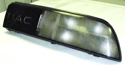

Here is the "final" product. You get the clear-effect (which will look better on a good, clean outer lens). And you can't actually see the reflectors & Bulbs!

Dude, that actually works! Nice job! Not bad.

Looks great! I think it would be even cooler if you could keep the black dividers (?) going across the length of the lens. That's my favorite part.

I was originally going to keep those- cause I like them too... but on a short-term easy-to-do project, this was easier. I may still try to do it the other way (cut & paste) just to see how well that turns out. But that will be a ways down the road.

    Im working on some clear lenses for my notchback but I had planned on the simple rout of using the clear between the red and the outter lens.. Cops around here will harass you cause your supposed to have so much reflective material so thats one reason why I plan on keeping the red in it.... But who knows..Maybe I can get away with it ehhe
    BTW!! Good job..looks schweet

    MinnGreenGT--You want a honeycomb pattern? What about finding the bottom part of an '85 engine/decklid grille? That's got the honeycomb pattern. You could lay that on a piece of poster board and spray the pattern onto that. Then (very carefully) cut out the shapes on the poster board. Before you heat and shape the diffuser lense, lay the poster board on the diffuser lense and spray with black paint. VOILA!! Honeycomb pattern. If I remember (generally my memory is about as short as my...well, you know), I'll bring an '85 bottom panel thing to Fierorama. Also, (if I remember) I'll try to fit a notchback tail light in the car. Not sure if I'll have enough room for that and the tail light won't be in great shape, but it might be something you can work on. Email me and let me know if any of this will help.

    Loki There is no reflective material in the red lenses. Its in the bumper on those little red reflector things.

    Looks like you've got a great idea on your hands! I'd really love to see what they look like installed/lit up with day/night pics. Is anybody going to try it with the black parts still showing soon? I think I would like it more that way, but would have to see it first. I don't have access to any "spare" buckets to work with, and I'm just not at a point in life when I can afford to put my car out of commission.

    Minngreen, It might be possible to add the black divisions between the defusing lens and the exterior lens. If you have the textured side inward a striping tape may work to simulate the division.

    That looks pretty good. I'm not a big fan of clear lenses but I am a big fan of doing something different. I don't think I've seen a GT with clear lenses so you could be the first.
    Something else for you to consider: If you move the back-up lights down to the reflector holes (like DXR-DAD) you could use that area as another tail light. Group the light pairs in the middle and the light pairs on the end and you could install sequential turn signals. I always thought that sequentials would look so cool on the GT taillights.

    Wolfhound- I just recieved an email from my brother (who works as an R&D developer/designer for Winona Lighting) and he pointed out that the manufacturer of the lens states that having the texture face the light source allows for an increase of light transmission of more than 30%... so that'll be a must.

    I think they look friggin cool. and that has given me an idea with the clear transparent stuff you bought, but keeping my round red lenses in the same place. I don't care if it looks ricerish, it looks good to me. umm do they sell that stuff in other colors like maybe a white, or green for my back ups?

    Simple... thanks. The lens I've only found in the white/clear- but the places listed above with the bulbs, have them in Green, Amber, Red, Blue, Purple, and some more... that might be the way to go. I'll probably get the green ones for my "PONTIAC" in the back!
