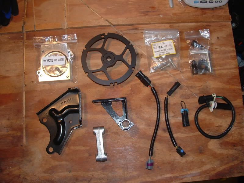

This is the crank trigger I'm referring to:

Marc with british car conversions makes a internal 7x wheel that can be installed on the 3500 crank, this is made possible because the 3500 uses a pressed on wheel, unlike the machined wheel the 3400 used. I'll try to get you a link when I get home.

here's your best bet.
http://britishcarconversion...d=128&category_id=28
the only other thing you can do it integrate the ring into the crank pulley. bolting something to the outer ring of the balancer would be a bad idea, as it the outer ring can slip.

I originally wanted to use Gravitic's step by step guide ( https://www.fiero.nl/forum/A...110502-2-103834.html ) and adapt it to the lx9. I also wanted to keep the 2.8 timing cover in order to reuse the alternator, compressor, dogbone, etc.... After much gnashing of teeth, I reverted back to the stock lx9 timing cover and the crank trigger from British car conversions( http://www.britishcarconversions.com ). I see there are now 2 crank triggers available for the lx9. One for FWD applications and another for RWD applications. You may want to contact them concerning which crank trigger to use to keep the 2.8 timing cover.
One of the main advantages of using the FWD crank trigger with the stock lx9 timing cover is the fact that migrating from obd1 to obd2 is much easier. All that's needed is the 24x balancer/crank sensor combo, a 3400 harness, and a late 90's venture ecm.
