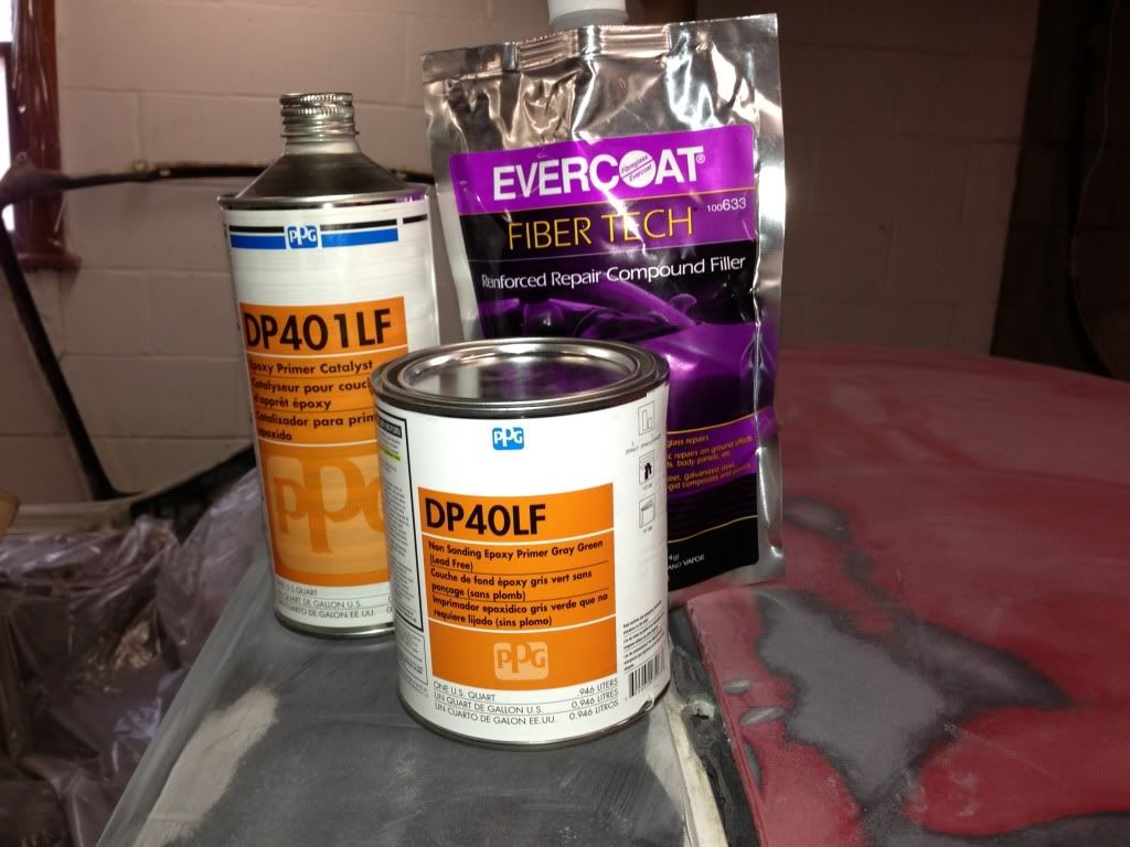

Found a local place that sells PPG!

Sweet you found a premium brand! How much did that stuff run you? Is that body filler in the bag?
KurtAKX
Posts: 4008
From: West Bloomfield, MI
Total ratings: 128
Report this Post03-09-2013 07:46 PM Click Here to See the Profile for KurtAKXSend a Private Message to KurtAKXDirect Link to This Post
Yeah, the Evercoat stuff in the squeeze out is SMC/Fiberglass filler. It was $37 with tax.
The PPG is ungodly expensive, it was like 57 or 77 for the quart plus more for the catalyst.
I debated getting it, but since the work I'm doing is going on after two paint jobs, some body damage repair, and some panels that have been chipped down to the bare fiberglass, I figured I needed, the best, stickiest, best sealing primer I can get.
If my car only had stock paint which was in good enough shape to work with on it, I probably wouldn't have bothered.
I'm glad you decided to go with the good stuff, you won't regret it. You will want to follow the instructions EXACTLY in order to get the best finish. If it says mix it 4:1 and to do 2 medium wet coats don't mix it 4:1.5 and do 3 coats. Follow it EXACTLY. You may want to go over the MSDS for primer and catalyst. Sometimes they have tips on application technique plus it always helps to know what you are dealing with in terms of hazards.
As for that filler, let me know how that goes and what kind of results you get. The plastic filler I use is called "U-POL" and is great quality for the price. Their finer "glaze" is good stuff too and they both use the same hardener.

Originally posted by jaredmurray88:
Ok roger dodger I have a hard one for you.. Where I work we have a 2K primer I believe kirker or proform but don't hold me to that and I have used the brand before and got great results with it as a single stage but on my fiero I want to use their clear with the euro clear additive or wet look additive. Sorry getting side tracked here but what do you think on the primer? We also have the etching primer but I really don't trust that on plastic.
From my experience, you shouldn't need to put any additives in clear. The key is laying it on smooth and getting even coverage with no dry spray. Plus, the more coats you put on, the deeper it looks. I have a hood I did some custom graphics on, and it has 10 coats of clear on it. 6 over the marbleized base and 4 over the graphic. It looks great. The key is a good color sand and buff after clear. Hit it with 2000 wet and the use a GOOD 3 stage buffing system. The buff can save crappy technique but it can also ruin a great gun finish so be careful.
Do NOT use acid or etch primer on anything but BARE STEEL. It will eat into plastic, fiberglass, bodyfiller, aluminum, ANYTHING that isn't steel. It can ruin a whole panel. 2 or 3 applications of a good 2K primer should work fine.
Will this product work on the rear decklid? I'm looking for a product myself.
https://www.fiero.nl/forum/Forum1/HTML/089703.html
I'll be watching your progress. Thanks for posting this. I'm probably worse off then you as far as bodywork novice goes. But I got some sandpaper and a dream!
We pay about 120 a quart for similar DBC on high metalic stuff (not to say you got a deal), it is just common to spend alot on paint. Unfortunately no amounts "sealing primer" is going to keep hidden solvents from leaking out of old body work.... In your case the age should have dried up any goo laying inside there, but you shouldnt expect to bandaid problems with material. Epoxy primer takes a bit of time, and the amount of use it has on a fiero is probably fairly low as a base, but it will offer a good uniform color platform for the potential blocking exercise to come.
I recommend that you use evercoat high build from this point onward.. it will help take the scratches down quite a bit, and take the flatness of your body work to the next level. I used a full gallon on my car and then some mostly because i made mistakes, but a gallon will take out all of the mess that your DA created in terms of waves and low spots.

I wont use any catalyzed primer. Kirker is a very low quality acrylic enamel. Its good for used cars as far as im concerned. I painted my race car with it once, and after a few days it was almost flat white. I never waste time buffing a race car, it needed some paint work every week . Ive never used any of their clear. Clear should have a wet look on its own, and any special wet look additive is a waste of money. I NEVER put on more than 3 coats of clear on a street car. Your just asking for it to crack, split or crowfoot down the road. I even only put 3 on one im going to color sand (taking a coat back off). Those 10-40 coat of clear jobs belong on show cars that never see the outdoors in my opinion. When they do crack (and they will) they are a total pita to remove. You think sanding off a bad 2 coat acrylic enamel job is hard, wait till you try 10. With that many coats of paint on a panel, Ill throw it away and buy a new one. If its something rare on a metal car, it gets chemical or soda stripped.
