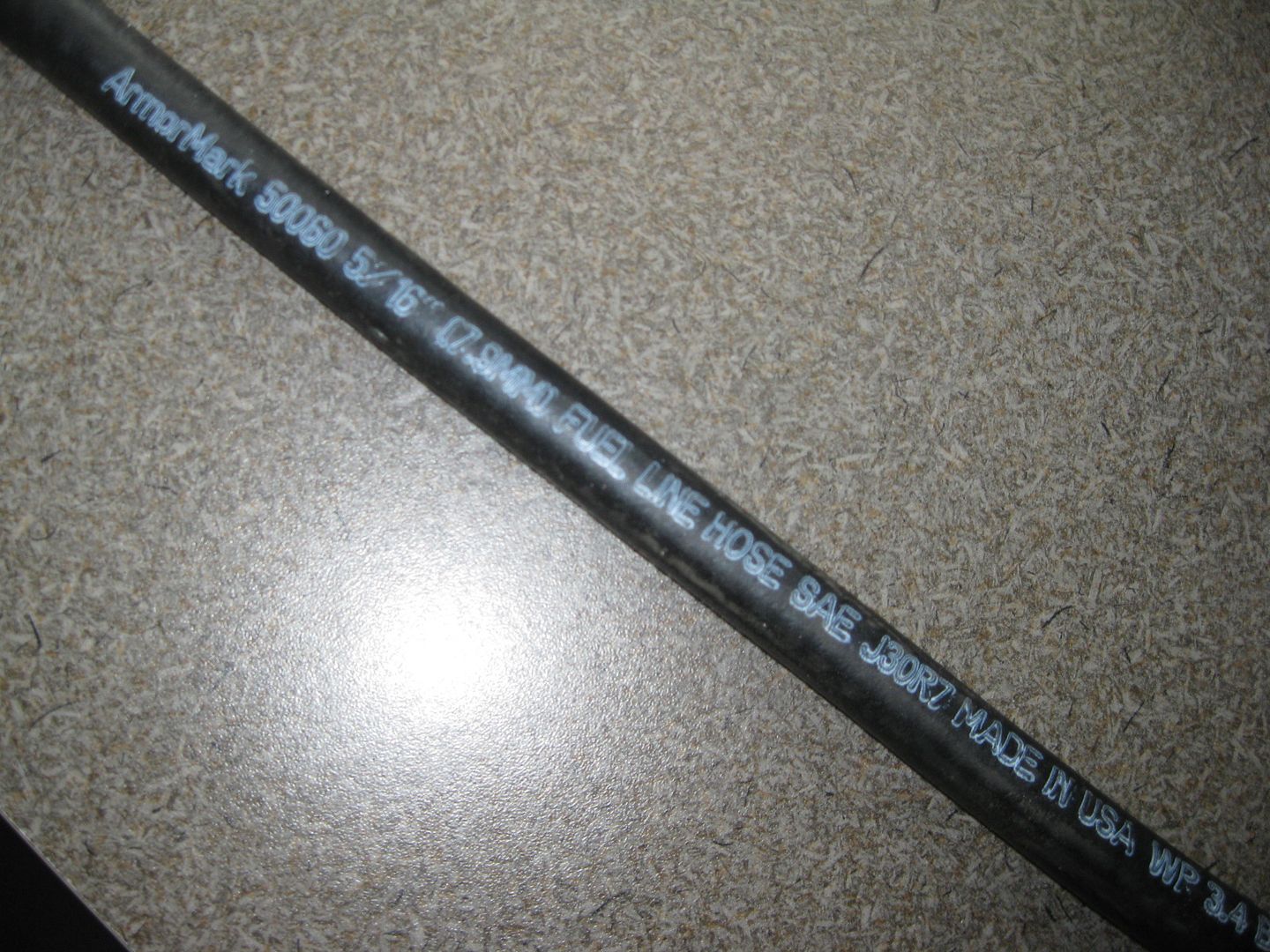

I dropped the fuel tank from an '86GT to replace the fuel pump. That's a story in itself, but let's not go there.
Anyway, I thought I should change the short bits of rubber fuel line that are attached to the fuel tank. They're probably original, and with the tank on the ground, this is the time to change 'em.
I phoned the local automotive parts store that I deal with, and I told the guy (who's worked there for at least ten years) what I wanted. I said the fuel line was for a fuel injected car and that it needed to withstand at least 40 lbs of pressure. I was told sure, they've got what I need.
So I go over and the guy shows me their spool of 5/16" rubber fuel line. It doesn't look quite as skookum as the old piece of fuel line I have in my hand. The guys says "Fuel line is fuel line." That concerns me a bit, but I buy it anyway because I figure maybe they only carry the "good" stuff.
I was feeling uneasy about this, so I did a search of the forums when I got home. There really isn't a whole lot mentioned over the years about replacing rubber fuel line, except for not using "regular" fuel line inside the gas tank. Anyway, I find This thread, and now I'm convinced that what I bought isn't safe to use.
Specificly ask for fuel injection rated fuel line. If it is not over $5 a foot, they are giving you the wrong stuff.
I was charged $2 for the 12 inches of fuel line I was sold. Why do I now suspect that this rubber fuel line isn't what I asked for?
Be careful out there!

Not enough information. What rating is marked on the hose?

When I mentioned J30R9 on the phone (before I went to the store), I could tell from the deafening silence on the other end of the line that the guy didn't know what I was talking about.
The metal cabinet rubber hose dispenser was marked "Goodyear", but it could've been stocked with anything. And of course I can't read the lettering/numbering on the side of the hose I got as it's all blurry.
From reading the few posts I could find in the archives, it appears that fuel line rated for carb use is no good. I don't know what I have here.
