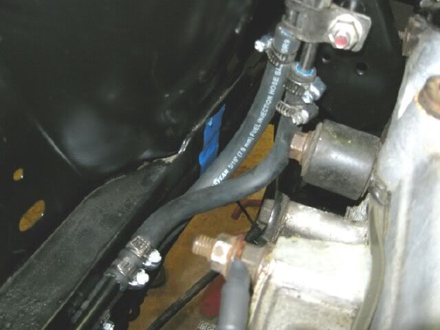

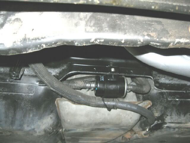

Originally posted by Reallybig:
On my 88 4cyl, the fuel lines run up the passenger side from the fuel filter to steel lines on the engine to the throttle body. this is somewhat close to the stock 4cyl exhaust pipe. I believe the fuel filter and return line assembly is the same on 88 4 and 88 6cyl fieros.
Yes, the 88 chassis fuel lines for both engines are pretty much the same.
On all my swaps, I move the filter to the center tank area and then run new hard lines in the engine bay and try to keep any lengths of hose to under 12" and keep the hose as far away from exhaust manifolds as possible.
The fuel lines are kinda hard to see in this picture because they were painted to match. They are steel from the center fuel tank tunnel, and wrap around to the side where they have rubber ends along the passenger frame rail.
[This message has been edited by fieroguru (edited 06-08-2012).]
