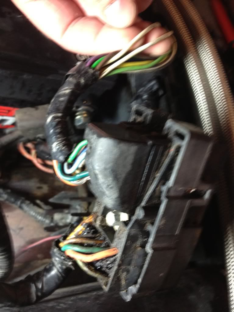

There is no original harness left in the car from what I can see. All the wires come through the firewall to the PCM behind the glove box... Should I be looking elsewhere?
The engine harness also plugs in at C500. It is located over by the battery box on the sidewall.
The white wire from the tach output of the ICM harness needs to be connected to pin C3 of C500

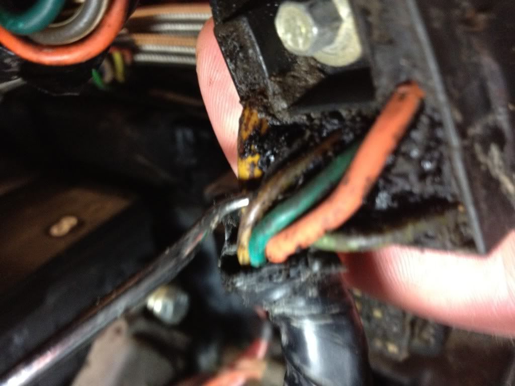

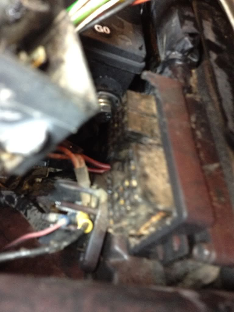

From what I can see The wire going into C3 is yellow? All the loom is taped up so much its hard to make out what's what..... The wires from the DIS route under the blower then merge into larger loom then over to the harness by the battery.
So... somewhere along the line the white "E" wire from the coils harness should go to the "C3" wire on the input side of that connector by the battery? The output side of the connector by the battery location has 2 white wires coming out of it...... I'm lost.

The harnesses have a bunch of black gew in them is that ok, or should I hit them with contact cleaner. I know it's probly there to keep water out, but seems like it would effect signal transfer..?

I am getting .4 ohms between the coil wire and C3, so they are connected... Where does C3 come out?
I hope I'm not checking all this if the car ends up just having a bad tach... The PO said the tach worked with the previous 4.9 swap but not after the 3800sc swap...
[This message has been edited by BAD88GT (edited 03-30-2012).]

That sucks! The PO probly knew it was bad and I just wasted a bunch of time.... Oh well I'm getting to know the wiring. LOL
Maybe The terminal/harness being so filthy between the engine harnesses is blocking signal... I'll clean it up and put it back together and test again. Just to be sure.

ya its possible. mine did that once... try this while its runing and everythign connected wiggle that 500 around, my tach would come and go as i drove. i cleaned the terms up a bit and took care of it.. i found it by accident i bumped the connector with my hand while it was running and the tach went out then came back.

ok. I cleaned up the terminals with contact cleaner and a fine wire brush. They're gold again! Should I get some more of that black gummy crap to seal it up again, or just use the dielelectric grease? I think that terminal block got very dirty because the screen has been removed under the grill above allowing more elements in....
