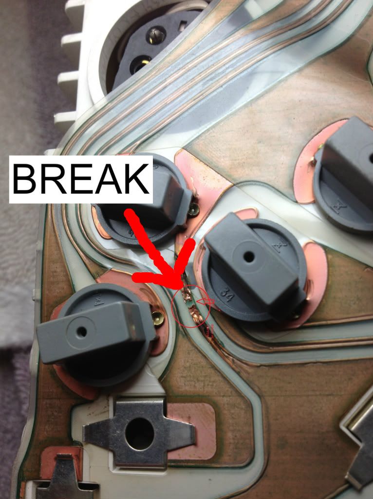

Found a break in the copper film on cluster. I cant see where it connects to tach though.... Anybody? Thanks.
First pic is Far, second is closeup.....:

I used to have some conductive silver paint used to fix ribbon speakers... Maybe if I can find it I could run it across the break....?

Something heated that up and caused the open.........
You can probably tin both sides of the break and solder a small jumper over the gap.

I've never used tin/tinned anything is that used for copper piping?
Do you think that break is causing the tach issue?

it looks like it feeds that light bulb

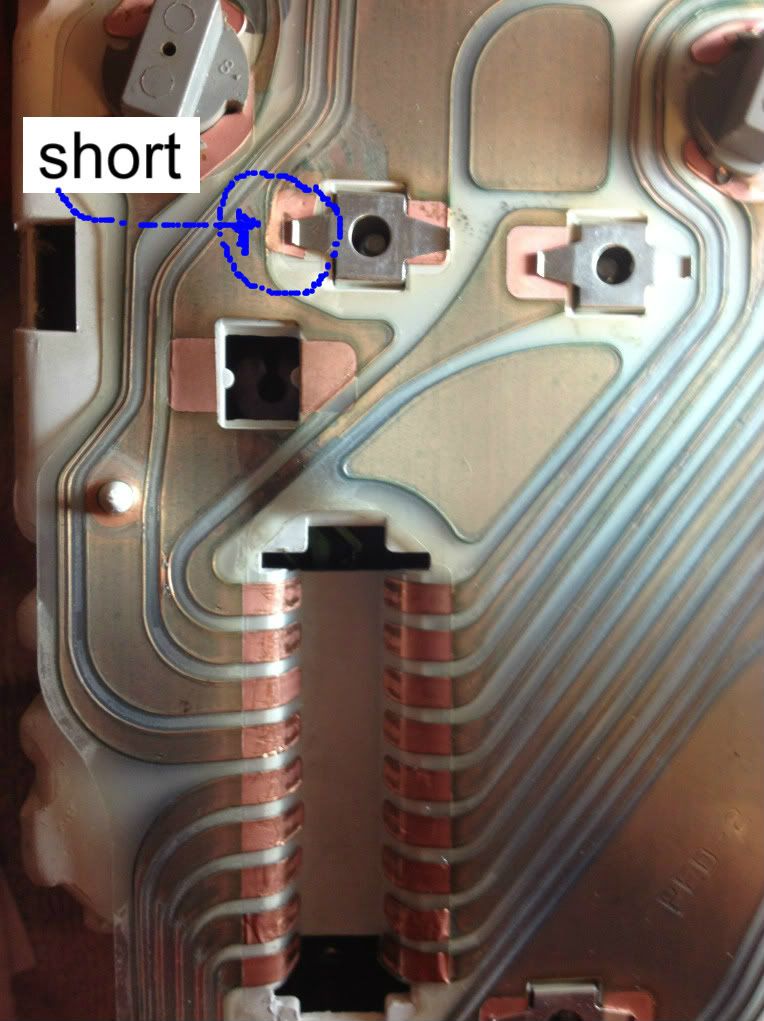

Found a short. Maybe this caused the problem...
[This message has been edited by BAD88GT (edited 04-06-2012).]

Fixed the break and short. Tach works now. Thanks everyone.
