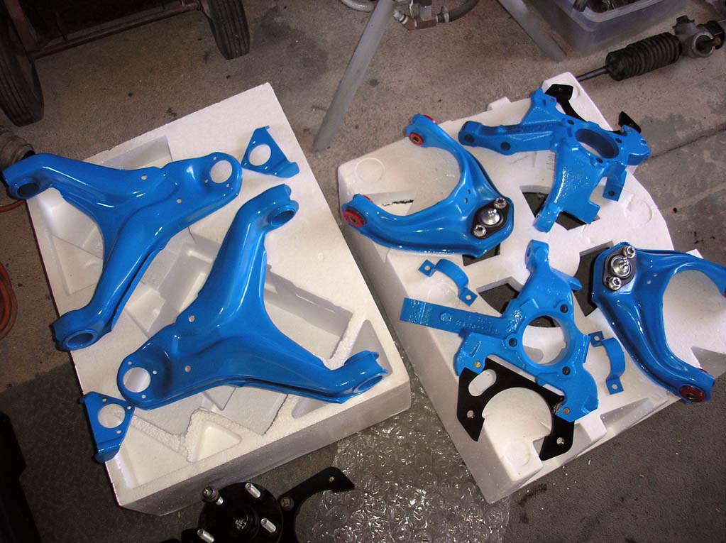

Originally posted by Dizzixx:
I replaced all the control arm hardware with new bolts and locking nuts. (BTW totally a PITA if you are doing it without actually wanting to remove the control arms) As well as replaced all the ball joint grease fittings including those on steering and tie rods and greased them with a grease gun.
I am doing this right now. Complete rebuild of the suspension and brakes on an 86. with the exception of control arms, everything is new.
This will be the Wife's Fiero. Her favorite color is blue.

Report this Post06-26-2011 01:56 PM Click Here to See the Profile for DizzixxSend a Private Message to DizzixxDirect Link to This Post
Nice. Powdercoated or painted? How much was it to have done?
IFLYR22
Posts: 1775
From: Tucson, AZ.
Registered: May 2007
Report this Post06-26-2011 07:46 PM Click Here to See the Profile for IFLYR22Send a Private Message to IFLYR22Direct Link to This Post
They are painted.
I burned out the bushings and stripped them down. Then they got tanked to remove the oils and grease. They got sand blasted after that.
Once they were bare metal, I used a self etching primer with a 2K gloss paint through my Harbor freight HVLP (cheap Chinese crap) gun. No clear.
It is way overkill, considering I won't be doing the chassis (space frame) that way...if at all.
-Dave
Adding:
I have no idea how much it was do get them to this point. I already had the tools and materials and did all the work, so I guess, the cost of the suspension parts (bushings, ball joints, etc...).
The black parts are Rattle can (off the shelf spray cans).
[This message has been edited by IFLYR22 (edited 06-26-2011).]
