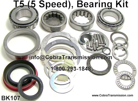

That sure looks like a sealed ball bearing on the back side of the input shaft. And straight roller bearings on the input side of it.
The only place they use tapered roller bearings are in the differential
EDIT
Here is what the manual says "The input shaft is supported by a roller bearing in the clutch and differential housing and a ball bearing in the transmission case."
Hmm So I guess it is supported by a ball bearing/roller bearing and no tapered roller bearings that you can shim the clearances out of.
http://i299.photobucket.com...cie282RebuildKit.jpg
EDIT
The sealed bearing on the input shaft takes the entire axial load from the mesh in any gear.
The sealed bearing on the output takes the difference between the input axial load and the differential axial load.
If those bearings were loose or worn, the transmission would make noise all the time, and the noise would be louder with load. Out of the Getrags I have disassembled, none of those sealed bearings showed any signs of wear (IE, feeling the motion, listening with a stethoscope, etc).

On a T5 input shaft you have a tapered roller bearing in the engine side of the input shaft.
You have a thrust bearing (64) - also lower right here
And finally a tapered roller bearing at the rear of the transmission on the output shaft. As stated before you shim those bearings to take out any end play.
