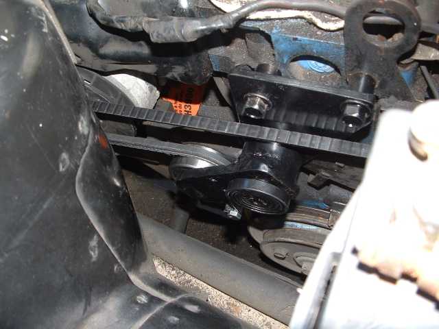

I'm getting pretty tired of having to re-tighten the alternator belt on my '84 duke every couple of weeks. (The '87-'88 dukes use a serpentine belt and a tensioner.) Any of you who have had the problem of a squealing belt at start-up know what a nuisance and embarrassment this is! It's worse in the rain, and by gawd, it rains here almost constantly this time of year.

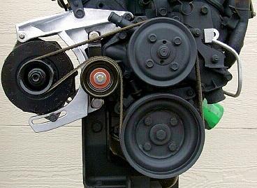

On my '86 GT I've installed Dodgerunner's belt tensioner and it works great.
Rodney also sells an idler arm/pulley for the 2.8. This is what it looks like installed.
So, I was wondering if anyone has ever made something similar to Dodgerunner's tensioner or Rodney's idler for the '84-'86 dukes? Just that little bit of extra belt "wrap" around the alternator pulley would probably make a world of difference.

The tensioner is still working just fine. I don't drive the 84 much anymore but it has around 5 thousand miles on it now.
Email me if you want more pictures or info.

Ray, thanks for chiming in. I've got a general question for you in regards to the tensioner you designed and built.
Had you at any point considered using the type of readily available tensioner (shown below) that Dogerunner uses (with his custom bracket designed for the 2.8), and if so, why did you go the route you did? Was it just a matter of using what you had, or was there something about that style of tensioner that wouldn't work with a custom bracket installed on the duke?
I wonder if the same tensioner could be adapted for a v style pulley?

All the factory belt tensioners I have seen are large with a lot of spring tension. There isn't much room in this area to to mount one but it could be done with some work. The reason they are so large and have such a high tension is because they tighten the belt between driven components on the engine. Lets assume that the tensioner is installed between the water pump and the alternator and so presses down on the belt to keep it tight. With the alternator charging this will tend to raise the tensioner and actually loosen the belt around the alternator pulley. That is why they have such a heavy spring tension built into them to overcome the horse power requirements of the alternator. If the tensioner is placed after the last driven part, which is where the slack of the belt normally would be, then the required tension at that point is greatly reduced. The spring that I used holds only a few pounds of force against the belt to remove the slack and keep the belt wrapped snugly around the alternator pulley. The more horse power the alternator calls for actually causes the belt from the crank shaft pulley around to the alternator to get tighter with the tensioner just taking up the slack.
I also have this same design on my 85 2.8 engine and it is working fine also.
I originally made one for my 86 4.9, and there are pictures of it in my other posts, but it did not work as well and I have removed it and went back to manually adjusting the belt when needed. On the Cad engine the timing cover extends out past the crank shaft pulley in some places. The factory cover has areas indented in the cover for the factory belt setup to run in but if you change the belts angle from the alternator to the crank shaft then the belt will rub on the timing cover. Not good.
I am not saying this is the best solution only this is what has worked for me.

Ray, in your opinion (since you've obviously spent some time scoping this out), would a factory belt tensioner not fit on the duke in roughly the same place that Dodgerunner has located it for his 2.8 application? It would be "easier" to use one of these tensioners IF it would fit as they're readily available and would require less fabrication than what you've created. I love what you've done, I'm just looking for the simplest solution.
I know that Dodgerunner has expressed interest in the past in creating a auto-tensioner/bracket for the '84-'86 duke, but the last I heard he still didn't have one of these engines to use as a guide.
