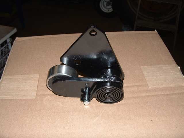

This is what I made to fix the problem once and for all. Notice that I have almost 180 degree wrap on the alternator pulley and almost that much on the drive pulley.
The spring keeps a constant force on the belt as it stretches and wears in. The alternator is locked at mid point of its travel so there is room for adjustment both directions.
It is a very easy installation using just two bolts that you can actually get to with out dissembling half the car. The belt is 4 inches longer than the original.
Here are the parts that I made from some metal I had laying around. I purchased the main roller bearing and two smaller rollers for the swing arm.
I have about ten hours of labor (fun) in it.
Ray

Cool! A completely home-made belt tensioner. Great for early Duke folks. Dodgerunner made a similar mod for V6 cars, but his mod uses a commercially available tensioner. He made the brackets to fit it to the engine. Check out his here.

I had the same problem with my 4cyl. The reason was that I was missing some of my alternator bracket to block bolts missing. You might want to check them.

This is a great piece of fabrication work.
As a nerdy engineer, I do have to mention that V-belts are not intended to be bent "backwards" and the increased strain and tension in the fibers at the bottom "tip" of the V will cause a shorter belt life.
This is actually the reason for the invention of the "multi-rib" or "serpentine" belt, is to be bent in both directions. Serpentine belts have lots of "little Vs" that have an equivalent surface area for contact but are not as thick so the outermost fibers don't see as much stress.
