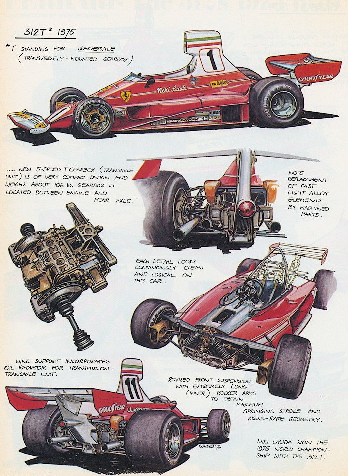

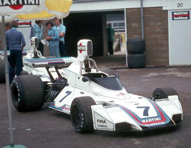

I did a quickie search in my vast automotive library and--
I you do it right, ram air gives you 1-2% increase in HP at 100 MPH.
Plus, the ram air pressure increases as the square of the air speed.
Anyway, it worked for these F1 guys, until the FIA forced 'em to lower the intake scoops heights.
