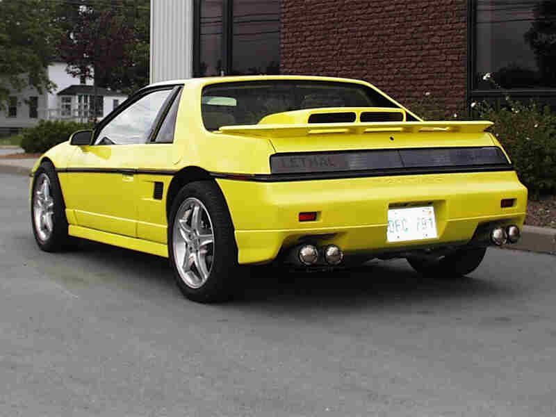

Kind of off topic, but in the same ballpark - you say a cowl induction scoop uses pressure (or lack thereof) to draw fresh air in.
So this...
A.) Allows hot air generated by the engine to be expelled, and produces more downforce by drawing air from the bottom of the vehicle, through the engine bay, out the vents?
B.) Pulls air via "cowl induction" into the engine bay, expells it under the vehicle, and generates lift?
I have always wondered about this, because the area behind the cockpit of the Fiero is already low pressure correct?
Thanks
--Will | ironwill2000@hotmail.com

Report this Post10-08-2002 11:17 PM Click Here to See the Profile for jstrickerSend a Private Message to jstrickerDirect Link to This Post
In the picture you post, there is no "cowl induction". Cowl induction worked (supposedly) by tapping into the high pressure area and flow reversal at the point the windshield meets the hood. That is a significant high pressure area. The problem was that as it was designed by GM, the area was so small that there was more suction going on there than there was high pressure. It may have helped slightly by allowing cooler air in, but not significantly. In the picture you posted, there is no windshield to cause the high pressure/flow reversal area and very little airflow coming there to begin with.
In the picture you posted, there would either be negative pressure or possibly even stagnant air there due to the fact that there is a lot of airflow disturbance from the roof area of the car. The flow would drop down (gravity works on air too) but it would be a toss up as to how much negative air you have there. What you do certainly have is an outlet to let out any high pressure air that might be in the engine compartment and openings up high to let convection draw the heat out of the engine compartment.
So the answer to your question is that air is moving out of the scoop in the picture and definitely not in it. And possibly more by convective activity than any actual airflow action.
John Stricker
