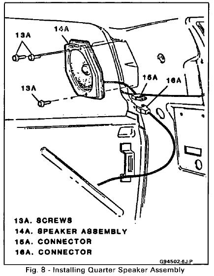

I already installed new speaker in dash and now getting ready to do the rears in my 88
What size does everyone use? Having a hard time finding 4x6 shallow speakers.
Will regular 4x6 fit ??

There is a plastic base that the stock speaker mounts to. You need to use this to keep the speaker flat so it doesn't "bend" to the metal frame of the car and it gives you a 1/4" more clearance.

You'll have to remove the inner B pillar panels to get at the speakers. As mentioned, speakers mount to a plastic bracket shaped to fit the curves of the pillar. As you know, the main problem is speaker magnet size and depth.
People have mentioned Pioneer and Polk Audio as fitting fine, but didn't give model numbers.
