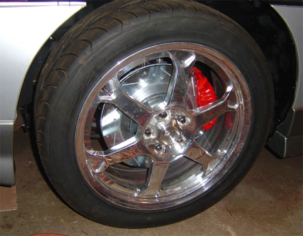

if I could buy a set like these for 400 or 500 I would, but they are forged 15 lbs 17 inch wheels, and I got them for cheap, because of the terrible paint job.
this is how they should look

Post that photo of what you have whereas some wheels are just have too many nooks and cranies -IE the stock lace GT wheels- to make them worth the effort.
BTW: There's one other option if you happen to know anyone that does powder coating. In which case you can then just strip the paint with off chems, sand any really noticable areas and powder coat them with near-chrome like we use on our intakes -below- I'd also add a coat of clear power coating over the chrome look.
