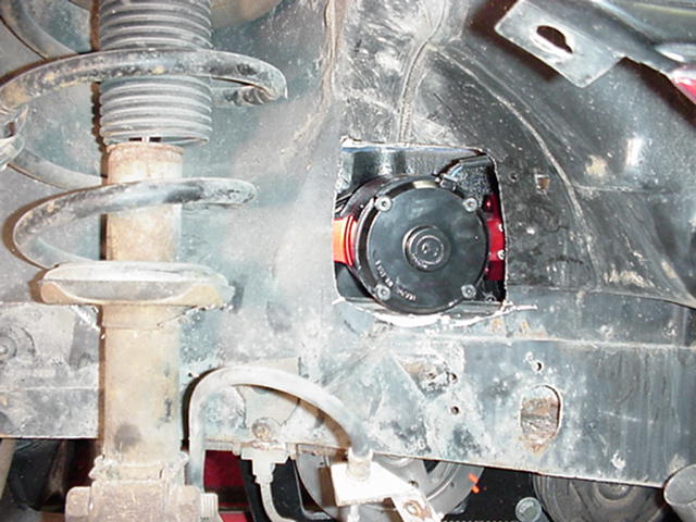

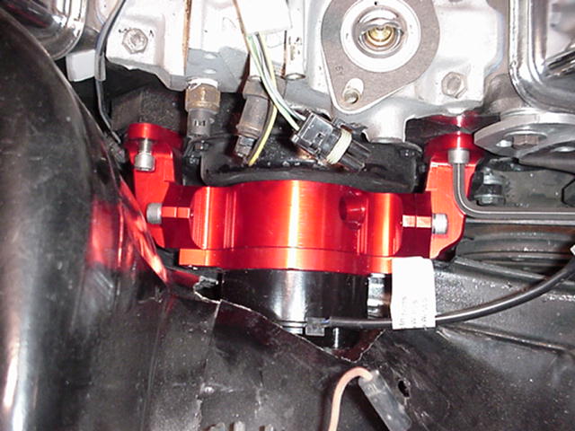

For those too lazy to click on the link, there is a photo of a CSI water pump mounted on a conversion V8 and another showing the sheet metal that needs to be removed. The plastic inner wheel well liner will cover up the hole once the swap is completed.

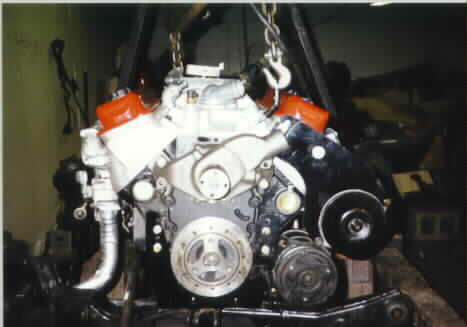

The Water pump mounts upside down, which doesn't interfere with it's proper operation. If you were to mount it right side up it would be necessary to do some frame cutting to clear the hose connections and the hoses. There is a a-symmetrical hole in the Water Pump and a corresponding hole in the engine block these holes need to be plugged as described in the Video Instruction Tape.

This images is larger than 153600 bytes. Click to view. Mounted mine backwards & used CSI's adaptors on the pump & the block. Just add hose between where you mount the pump.

Remote mounting the electric pump is the easiest solution to avoid trimming the wheel well. Several have mounted them where the battery was or even down below that panel.

The hole you already have should allow clearance for the electric pump. I have had a CSI pump on mine for 5 years now without a problem.
