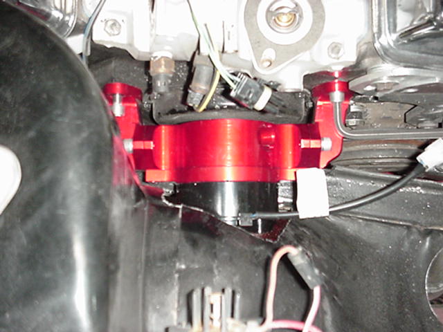

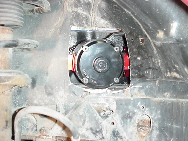

Here are some pics of the CSI waterpump and the sheet metal that is displaced by it. AS opposed to the frame cutting you have to do with the Zumwalt style kits, this sheet metal is a pretty minor modification. You will note that the plastic inner wheel well liner will cover this up upon completion. Anyone who would choose to put in a 6 banger instead of a SBC because of this is not thinking things thru very well.
Archie

Thanks Archie I feel much better now that I have an idea of how it is ,I can live with that.
