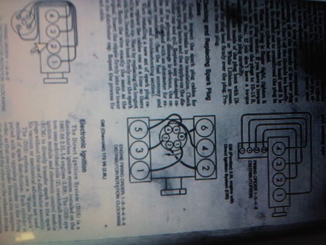

My friend and i check the wires, we werent sure of the plug diagram, we looked it up in a maintenance manual for a 82-90something s-10 with the 2.8 v6 this is what we were given:
Can someone please tell me if this is correct for this car?

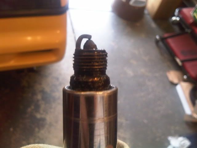

Removed the plug from the down cylinder, found this:
Needless to say, im replacing the plugs, someone decided to put Bosch in a GM...

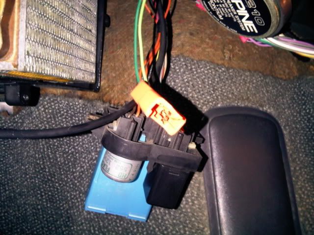

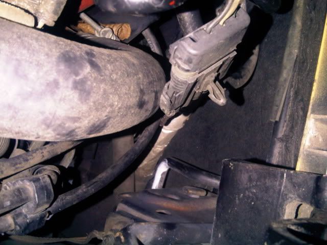

I also noticed this random wire routed to the decklid:
Sorry for the orientation, turn your head 90 degrees.
It looks like a botched up harness and i dont see any reason why there would be power to the decklid, any ideas?
It is for the power release solenoid on the decklid lock. I believe they are still wired up for it even if it was not optioned, but I could be wrong; I know my friend's 88 coupe is like that, got all the wiring just no switch or release solenoid.

ok great thanks, just making sure a self proclaimed electrical genius tried to make his own harness.

Ok so new plugs, AC Delco to be exact, and a new air filter...same problems.
It runs on all cylinders now, thats a plus. It takes anywhere between 5-10 seconds cranking to get it to start which is new. Right after we put plugs in it, i went for a drive, much smoother but no power. Suddenly, it stalls and i start it back up, it didnt idle while it was hot but as soon as it cools down, it will idle, albeit rough. On a cold start, it will idle around 1500, drop to an almost stall, pick back up to 2000 rpm, back down to 1500 etc...all in a 30 sec. cycle.
It still pours out fuel as i had to leave my garage after it idling and almost going blind from the fumes.
I pulled out the #2 spark plug, what do you kno, its fouled. The threads are covered in oil and the electrode is covered in deposits.
Any more ideas?

Possibly a damaged piston for the following reason: You show in a previous post a picture of a spark plug with the ground strip pressed into the electrode. I saw this on three different spark plugs on the same engine at various extents and each plug coralated to a chipped piston. The engine had experienced several cycles of severe detonation which chipped three of the six pistons and pushed the chipped pieces into the spark plugs. Initially when the engine ran poorly afterwards I thought the detonation forces some how bent the ground straps on the plugs until not too many miles later perhaps a few 100 the engine started to burn oil. It was turbocharged and digressed to a point where oil could literally be blown out of the valve covers from combustion gases getting past the pistons.
The engine was disassembled revealing the damaged left bank pistons and broken piston rings that had carved a groove into the cylinder wall. You don't need a turbo to damage pistons, detonation alone for any reason can do it especially on the cast 2.8L pistons, the ones I damaged were hypereutectic. It may sound like a stretch but the excessive oil fouling of one plug and excessive emission of poorly burnt fuel suggests there is a serious problem with that cylinder.
I hope I'm wrong, but something likely bent the ground on that plug internally. Maybe someone dropped something in the engine while working on it and didn't want to remove the head to get it thinking it was small enough to pass through. Had a friend drop a carbuerator screw in the intake in an old school Impala and follow through with the above knocking a hole in a piston.

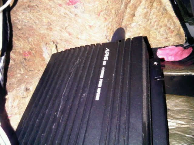

So new proble, i suspect is a bad heater core, if it sits, vapor starts to come out of the dash and there is coolant dripping on the pass. floor.
I removed the cover and there are puddles of coolant in there. Im trying to dignose whether its a bad core or there is just a loose line or the like, any suggestions?
Also, while under the dash i saw this:
Im assuming the previous owner put this in?
And lets play name that connector!
It looks like the factory speaker connection that was just left there after the amp was installed, correct me if im wrong.
Thanks.

Bad core - replace the rubber hoses also. The 'rot' and start to leak. First indication is condensation on the windsheild and the smell of antifreeze. It is possible to get condensation on the windsheild when running the defrosters with the air on cold with Air Conditioning because the AC runs while on defrost. So condensation on the windsheild isn't always a 100% indicator of a leaking core.
Heater core $42.79 (AC) $44.79 (No AC) + Shipping - Rock auto
http://www.rockauto.com
You had to disconnect the heater hoses from the core right? And those connections are outside the heater box in the front trunk.
Connector - Emergency Flasher and horn relay
--edit
oh the ORANGE connector. IDK - it doesn't exist on my spare '86 GT harness
Amp - no idea
[This message has been edited by phonedawgz (edited 08-12-2010).]

Connector for the factory subwoofer?
