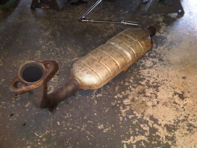

Victory! unfortunately it wasnt clogged like i had hoped...o well...hopefully im going to pick up that cat delte pipe this afternoon just waiting on a PM from the guy...once i get that on i will throw it on and start diagnosing the high idle.

If it's empty look for stuff plugging the muffler.

and im assuming the only way to do that is to remove the muffler? i was really hoping to not have to deal with all those dam springs.

You could run the car with the cat removed, would be loud, but would reveal if your exhaust piping downstream of the cat is messed up.

Bang on it with your fist. If it rattles yeah theres stuff in there. How important is it that it runs well after your finished? So if you weld the cat on, and your still short on power how are you going to get the stuff out?
idk how much stuff is in there or if it's a problem. I do know what I would do if I were working on my car and in your spot. Yeah those springs suck

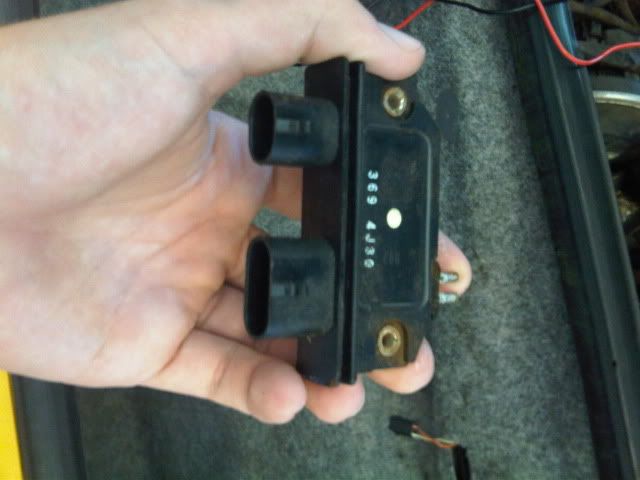

When hot runs like crap and has stalled before? Sounds like an Ignition Control Module going bad. You can have them tested for free at places like Autozone. The Ignition Coil has also been known to get weak when overheated.

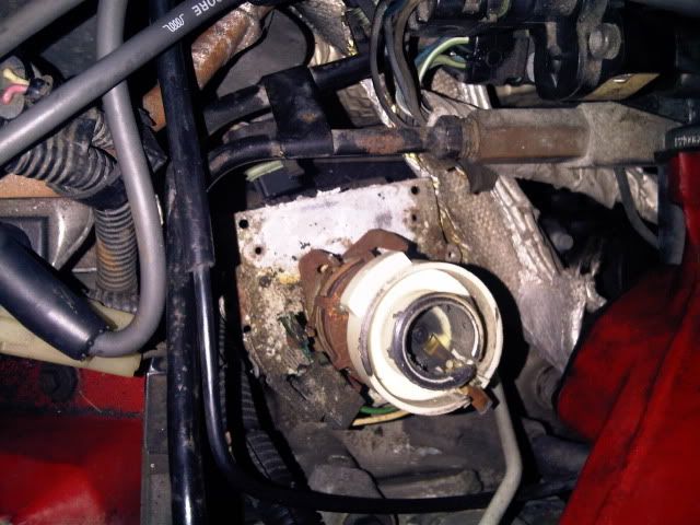

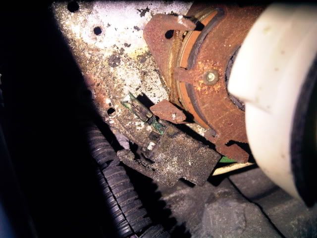

Ok so i attempted to check the resistance of the coil but my leads for my DMM were too large to fit into the slots so i cut 2 wires and put them in there as leads. I couldn't get a reading at all for the 2 that are supposed to read high/infinite. The other reading was around 12 Ohms.
I then removed the distributor cap and removed what i believe is the ICM, can someone please confirm?
when i removed it, the connector that is inside the cap that plugs into the ICM was very loose then i found out:
One of the wires in the connector had separated but it was still attached to the prong, could this be the cause of my problems?
Also, the plate that the ICM sits on looked like this:
Is that supposed to be bare metal to ground the ICM? There was thermal paste on it though. Im going to take the ICM to autozone here in a bit and have them test it.
Thanks!

Report this Post09-02-2010 07:42 PM Click Here to See the Profile for BushemonSend a Private Message to BushemonDirect Link to This Post
pic#1 is your control module
pic#2 is you pick-up coil ( looks like it came out of it's connector) Clean it up and test it or just replace it $10 part (more work) change O-ring to if you do take it out, no oil leaks from there!!!
or get whole new distribtor for $150ish if that's an option (Much less work) and you'll know that it good.

Whats up with your rotor?
It looks all messed up. Is it running into the top of the cap? It should NOT.
That pick up coil is toast.
As per previous posts replace that O-ring. It's cheap now and it WILL leak oil if you don't replace it.
[This message has been edited by phonedawgz (edited 09-03-2010).]
