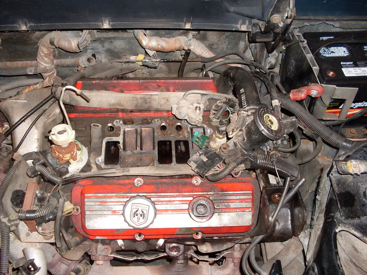

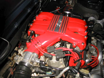

Ok, so i finally decided to get off my a$$ and start doing some things on my to do list (and its a long one...)
I have a stock 2.8 in an 85 GT, and I'll be doing this all with the engine in the car...unfortunately.
Here's what the plan is in no particular order...
- Replace the plenum and valve covers with the awesome powder coated stuff i got from a member on here a while ago (electrathon?)
- Take off, clean and paint various other parts that need TLC (TB, heat shields, batt tray etc...)

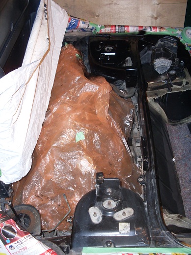

- Remove the filthy insulation and paint
- Replace ignition parts (nothing wrong with them but a good tune up never hurts)
- Port exhaust manifolds
- Try to get my cruise ctrl working
Is there anything else i should get into while i have my hands dirty?
Ill start with a couple questions (i bet there will be quite a few)

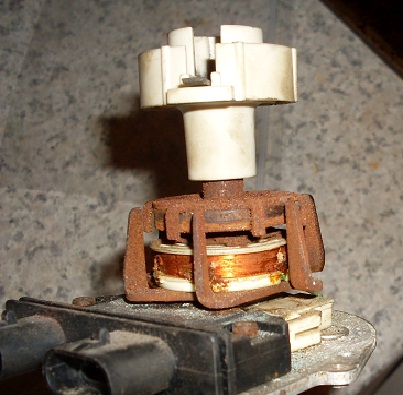

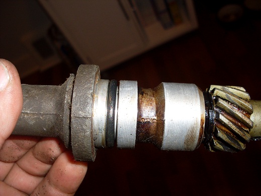

1. Should i replace my distributor? It is pretty rusty, can i just clean it up with some steel wool?
2. How important is the engine bay insulation?(Edit: i mean the stuff on the firewall)
I have seen threads on here where ppl replaced it with heat resistant stuff. Has anyone ever just taken it off and left it like that? Will i cook? Is it risky?
Your help is appreciated!

You should not need to replace the distributor so long as the fingers do not touch each other. Change the cap and rotor if you don't know when it was changed last at least though.
For the insulation, you can take off the sides and underneath, once cleaned up, will probly be some fairly good looking paint. Just clean it up as best you can. The insulation on the firewall should not be taken off unless you are going to replace it or all you will hear in the cabin is the sound of the engine. Not only is it for some heat but for sound deadening as well.
About the exhaust manifolds, I would not attempt to take them off while the engine is in the car unless they have been taken off recently. You will be very angry if a bolt breaks and you have a killer exhaust leak until you can pull the engine. I have always, ALWAYS, heated manifold bolts with a torch to get them out. Getting broken bolts out of the head are not fun.
You will be surprised what a day of cleaning and a can of paint can do to the engine bay. World of difference. Good luck

I tore out all the insulation in mine and sprayed in rubberized undercoating and painted that. I haven't had any problems with it, and it looks good.

Good idea! The 2.8 can be a very good-looking engine when cleaned up. I keep mine clean since I rebuilt it 4 years ago and I did many things (and more) of what you are planning to do. Here's a pic of my trusty V6 from a few days ago:
I would remove it (mark the position before you do!) and take a wire wheel to it. Install a new pickup coil while you're at it. And a new ignition module or at least remove the old one, clean underneath and apply new heat-sink grease (or whatever the stuff is called).
I left the stuff on the firewall and removed everything else. I think it may be hard to replace the firewall stuff with the engine in the car.

Thanks for the tips guys. I'll just try to clean the distributor up as best i can. I dont wanna mess with taking it out if i dont have to.

I think you guys are right about the insulation. It's tough to get at it with the engine in the car. I'm just going to remove the stuff from the strut towers and clean the crap out of the firewall stuff.

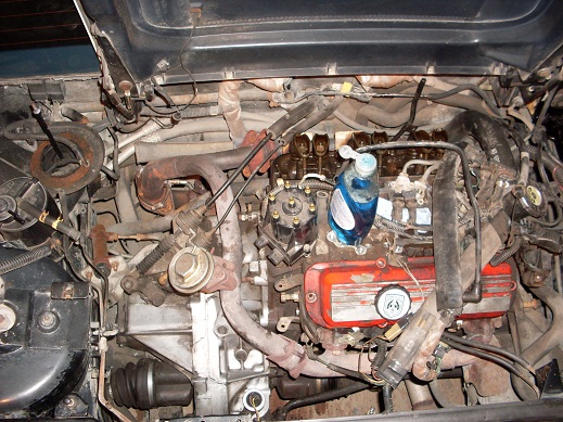

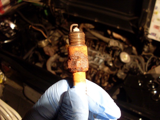

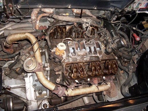

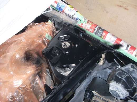

Did a few more things...
took off the valve covers, engine hooks, heat shield stuff

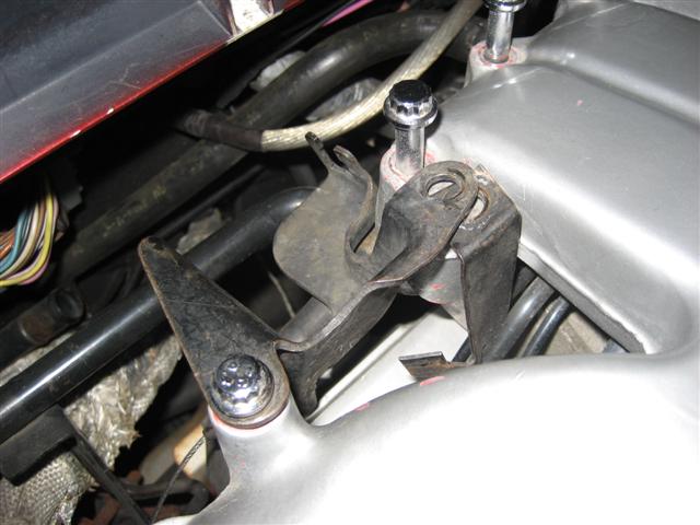

Forgot I found this earlier...

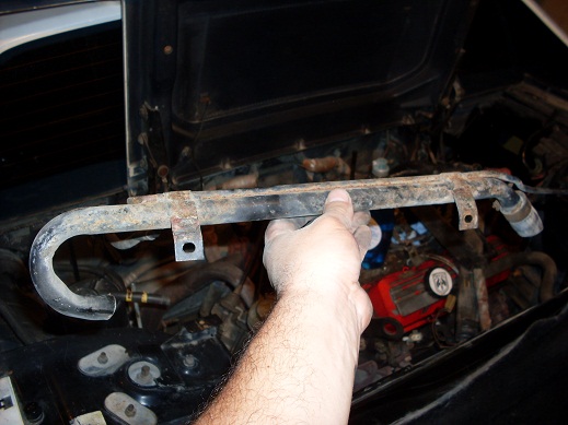

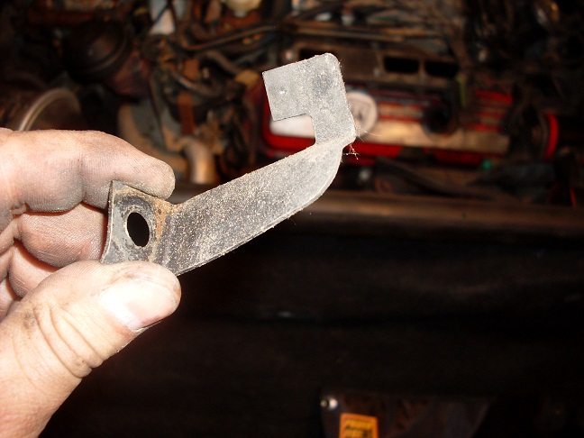

Can anyone i.d this bracket? It was wedged in between the firewall side spark plugs.
[This message has been edited by Dougie Murder (edited 06-21-2010).]
Tony Kania
Posts: 20794
From: The Inland Northwest
Registered: Dec 2008
Total ratings: 305
Report this Post06-21-2010 12:32 PM Click Here to See the Profile for Tony KaniaSend a Private Message to Tony KaniaDirect Link to This Post
Goes like this...

Report this Post06-23-2010 06:14 PM Click Here to See the Profile for Dougie MurderSend a Private Message to Dougie MurderDirect Link to This Post
Thanks Tony!
So i guess that holds one of the larger vac lines under the plenum?

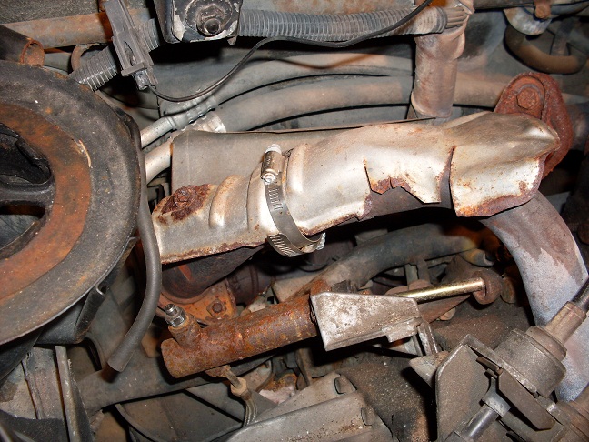

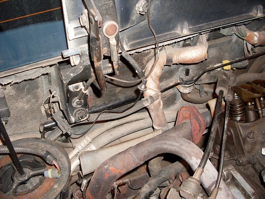

My Y-pipe heat shield was clamped onto the pipe and wrapped in some fiber stuff...pretty sure it didnt come like that.
Does someone have a pic of how its supposed to look? Where did it attach to originally?

I am pretty sure that is what it does. I am not near my car right now. I will take a gander at her later for you, but basically it goes there. The heat shield on yours looks to be in pretty rough shape.
In this pic, you can see how the heatshield bolts to the shield for the coil. On the front of the heat shield, there is a U shaped area that bolts to the engine block. There will look like a bolt snugged against a bolt on the drivers side front of the head.

Report this Post06-23-2010 07:49 PM Click Here to See the Profile for fierosoundClick Here to visit fierosound's HomePageSend a Private Message to fierosoundDirect Link to This Post
Holds plastic thingie for spark plug wires.

The heat shield i am talking about is different tho...Im not talking about the one that sits near the distributor. The heat shield in my pic is located above the O2 sensor, near the slave cyl.
Did the Fiero come with a shield there? The PO might have put this one there...i'ts pretty ghetto.
Thanks Fierosound.
So this sits in front of the TB cable bracket, and holds the spark plug holder thing, because the spk plug wires are supposed to be routed under the plenum? Is this the way they came from the factory?
My wires were routed like tony's around the top of the plenum.
The plug wires drop through the gap to that wire clip and go under the throttle cable bracket.

Doug, that heat shield you pictured looks like it came off a catalytic converter. It is definitely not a stock Fiero item.
Just out of curiosity, do you plan on re-routing wires, hoses, etc to try to reduce clutter? If so, you might want to visit this thread:

So that shield i have in the picture is not a stock part...is there one there usually? I assume there should be one there to keep heat off the slave cyl.

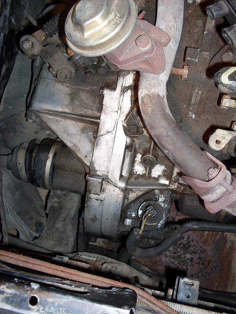

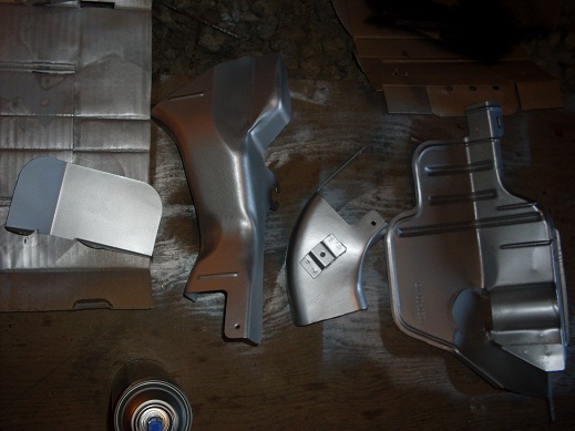

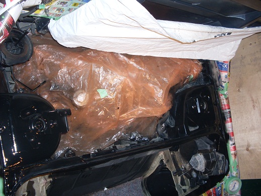

Heres some more stuff ive done...cleaning is taking forever.
Cleaned up the heat shields with a wire wheel and painted with "aluminum" dupli-color high heat engine enamel.
Started to tackle the trans cleaning...it looked the same as the area to the right of the exh. pipe before.
Dish soap, scotchbrite pads and elbow grease...
Here's my bucket after round 1

Hey Doug, in those heat shields you pictured above, the two in the middle cover the exhaust Y-pipe. There are no other heat shields on the Y-pipe. Also, the slave cylinder has a separate heat shield, that mounts to the slave cylinder.
Lookin' good so far!
Oh ok thanks!
I dont have that shield for the slave....anyone have a pic of it on? I did a search but turned up nothing.
Dougie Murder
Posts: 538
From: Toronto, On,Canada
Registered: Sep 2007
Report this Post07-01-2010 01:29 AM Click Here to See the Profile for Dougie MurderSend a Private Message to Dougie MurderDirect Link to This Post
It's coming along....
Before...
After....I now have a transmission...instead of a lump of crap.

Managed to paint the strut towers and surrounding area...
Parts are on order. Engine gets put back together soon!!

Coming along... i pulled the distributor like you guys said...the O ring looks good...
But the rest looks lke crap and the fingers do in fact rub together. I'll have to contact one of the fine folks on here who rebuild these and sell them.
This looks like a good product

Report this Post07-22-2010 01:46 AM Click Here to See the Profile for phonedawgzClick Here to visit phonedawgz's HomePageSend a Private Message to phonedawgzDirect Link to This Post
No matter what the O-ring looks like, if it has been in the car over a month replace it. It's dirt cheap and when it leaks it just plain old sucks.
$0.51 from Rock Auto..
$1.09 at Advance Auto - and if there is a store in your town, they most likely have it in stock.
http://shop.advanceautopart...ILTAMS_1422299258___

Well...Ive had my plate full recently...I'll spare you the boring details...but i managed to do a few more things today and I hope to use the long weekend to finally but this to bed.
Did the spark plugs. man these things were super tight. I snapped 5 out of 6 trying ti get them out.
Below is a pic of one of the firewall side plugs, its a decroded piece of crap, probably from rain water collecting.Would the decklid drip guard (taken off during the recall) prevent this??
Also i cleaned the old gasket material off the lower intake and wrapped most of my exhaust with heat wrap...I ran out tho...need another roll to finish off the firewall manifold and little bit of the Y-pipe.

Report this Post08-01-2010 02:32 AM Click Here to See the Profile for Tony KaniaSend a Private Message to Tony KaniaDirect Link to This Post
Originally posted by project34:
Does anybody know the specific source for that chromed oil filler cap on the rearmost valve cover?
I ask because that chrome oil filler cap looks great in my opinion, but I've not been able to find one, and it also doesn't appear to be a chromed version of the stock Fiero one, because I think the stock one on a Fiero usually is flat or recessed rather than domed like the one pictured above apparently is.
I believe that I had bought that about 6 years ago @ Pep Boys? Best that I can remember, sorry.
On those plugs, don't forget a bit of dieelectric grease on the boots, and some anti sieze on the plug threads. Just makes life much easier down the road. Also insulates the plug from water.

I wanted to comment on the slave cylinder for the clutch. I couldn't find a heat shield for it either so I made one that mounts to the slave's bolts. I think the bolt was long enough to just slip the shield on and add an extra nut. Anyway it's basically a rectagle the length of the body with tabs. one for the mount bolt and a tab for the relieve valve. In looking at your heat shields, I noticed your missing some. There is one that goes under the coil that the side attaches to. There's one that comes around header at the alterator and a major one for the firewall side header. it gets really hot in there. Have fun on your build. it's worth it in the end. There is one thing that you'll hate when it's all done and it is keeping it looking that way. Cleaning sucks. Makes you want to just pull the engine out and start over. You didn't here from me though but you'll see.

Here's what the clutch shield looks like if you can make it out. It was a rectangle but then I bent it with a vice to make a half an octagon. Notice the cut out? That ends up being the tab for mounting. On the left, there's the other tab for the relief valve.
Here's some of the other shields that your missing in that picture of yours. This next one shows the shield under the coil.
Sorry for the blurriness. Alternator heat shield followed by the firewall shield.
I sprayed all of them with the VHT paint 2000°. The firewall one is an extra that is powder coated chrome.
------ That oil cap is available at PepBoys in the Spectre section. I have one also
