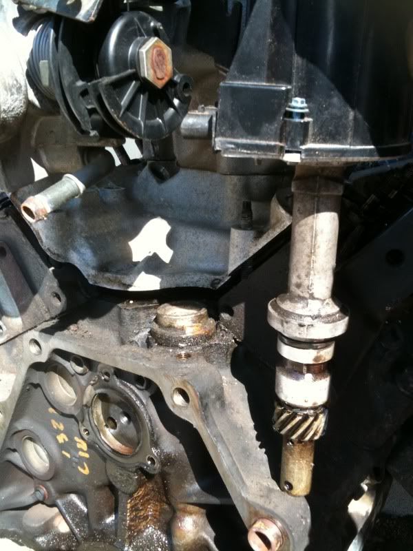

I've got a 3.4 and 2.8 lower intake manifold,i'll take pics real quick and you'll see the height difference.
When I get to the house i'll put the top manifold on the lowers and set them on a 3.4 motor so you can see what's going on.
Might even have a dizzy laying around I think.

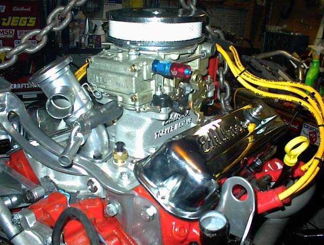

You can ditch the ECU, get a few different cams and go as high as .5" lift, and get many performance parts from places like Jegs, Summit Racing and P.A.W.
With the right parts you can get over 230hp.
Here is what my carb'd 3.4L looked like:

That said and done,here's the pics I promised.
Hopefully it will show what everyone is talking about to the OP.
This is a 95 camaro 3.4L block and lower intake.
This is the stock camaro 3.4 lower and upper intake from the rear(driver side on fiero) where the dizzy is.
From the front
Rear with dizzy held up to it (I'll pull the cam and cap cover later to install dizzy for clarity.)
This is the 3.4 lower with the Fiero middle intake bolted up.
And both lower and upper
And the upper from the Camaro next to the mid/upper from the fiero.
And of course the most important (had to edit as I forgot)
Here is the Camaro intake in the correct position on the 3.4 block (backwards/rear facing)
Carbon shows a pic where the intake has been notched for the dizzy.
That will work,but you will also need to work out all the other stuff as the intake is facing the opposite direction.
Not impossible or even hard,but most people don't have the tools or talent to do alot of this stuff at home.
Hence why the camaro intake is not a bolt on affair I think.

I was referring to a topend swap,the whole thing-heads and all.
An intake swap would be...well an intake swap
I'd love for you guy's to go into the 3.4 carb swap also to see what is out there/being done.
That 3.4 doesn't have a future yet,but among the three possibilities is carbing it (have a friend i'm doing a swap for and he wants carb for simplicity..)
I've yet to look into intake options,figured they were out there as the 3.4ht is sold as an upgrade for carb 2.8's and not fuel injected.
So GM performance likely has something out?
Do a search in the Archives for "Oreif" and "3.4L carb" and you will see many threads with many pics.

No sensor's on a carb engine other than oil pressure and temp sensor (if you like guages).
Offhand not sure if the VSS is an input to the ECM/output to the speedo or what so not sure about that.
Fan control will cost you 15$ at autozone.
ECU should be completely disgarded pretty much.
Back in the day a guy I know did use an 89 truck pcm,replaced the TBI with a carb/TPS switch and still ran the ECM for spark control.
Said the jump in power was crazy.
I know there are alot of 3.4 carbs,but the better place to do a search for those really interested would be thirdgen.org or s10forums.com i'm betting.
Oreif,i've read several of your other threads and I will definately check that thread out when it's time to make a decision.
[This message has been edited by DefEddie (edited 03-04-2010).]
The ECM can be removed. All the gauges in the dash go thru the connector on by the battery. While some of the sensors like the VSS and Tach pulses do go to the computer, the gauges are wired as well. The fan switch sensor still works like stock. The computer has it's own temp sensor and that gets discarded. Actually my car still has the ECM in it. The only reason is because of the fuel pump safety feature and fuel pump prime. In an accident the fuel pump relay is turned off so if there is a leak it won't pump fuel out. Also when I trun the key on there is the typical 3-second prime to pressurize the fuel lines. If I recall this is teh only line you need to jumper out if you are removing the ECM.
As for the CES light, I just removed the bulb from the dashboard.
For wiring you just need the hot wires for the ignition and coil, The tach wire, the gauges (oil, temp, battery), the fan switch, and add a wire with switched power to the electronic choke. I hooked the choke up to the TB1 power that went to the injectors. This line is fused under the dash so it worked out well.
The auto trans wires, A/C wires, Alternator wires, starter wires, etc. all stay stock.
For fuel supply you just install a 4-cyl Fiero fuel pump and a Holly 12-803 fuel pressure regulator. The carbs use 4-8 psi of pressure. Setting the pressure to 6psi seems to work very well.
You will need a distribiutor from a 1985 or older S-10 pick-up truck with the 2.8L V-6. Remans can be bought for around $90.
