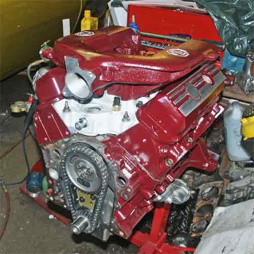

Someone here, (awhile ago) posted that they cut apart & rewelded the upper intake making the neck alot larger. It was Posted WITH Pictures as I remember. Does anyone remember that one ? re post it on this link ?

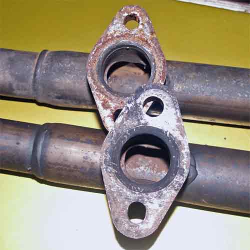

Definitely port the exhaust logs and the y pipe. Be sure to gasket match the flange to a new exhaust gasket,
You want it to look something like this"
Also the Y pipe but that requires cutting the pipe and then welding it back together - if you have a welder and skills, it's cheap. Aftermarket ignition parts will do nothing for you unless your stock parts are shot. Good quality AC Delco parts will get you the same performance as anything else on the Fiero. Check out the inside of the Dizzy. Many are full of rust and debris. Make sure there are 0 vacuum leaks.
Intake problem is the top plenum then work your way down to the middle and the bottom. No matter how much porting you do to the bottom and mid, the top will still be an issue. Best thing is to get the exhaust opened up - even a high flow cat helps and make sure it is tuned correctly, all sensors are working, etc. Remember that the Fule is controlled by the ECM If your sensors are old, it will run OK but not perfect. Check for codes even if the SES light is not on. Make sure the timing is correct. Do not expect a firebreathing animal as they simply are not. They have fair power but they were designed for economy and handling. A stock higher mileage 2.8 that has not been well cared for will not take too much "hot rodding" before issues will start to arise. Good quality Oil and Oil filter is another place to look for - well maybe not performance but for reliability. Good luck!

Wow, you did a REALLY good job with that porting work. I bought a ported set MANY years ago when I didn't have the proper tools and was far less comfortable working on cars and experimenting. I was told that anything past what I have (now) would weaken the manifold. Obviously, In the past 8-9 years (or 10?) I've learned to weld, rebuild engines, and restored a couple of cars so maybe when I take my engine out this Spring I'll give them a second look. Did you have any issues with grinding out the inside of the exhaust flange? Did you re-weld the inside of the flange or support it with additional metal on the outside?

Report this Post01-08-2010 10:50 AM Click Here to See the Profile for BillSSend a Private Message to BillSDirect Link to This Post
You have been getting some well balanced advice.
Be aware that porting the exhaust manifold solves only part of the problem - the crossover pipe needs work too.
If you don't want to spend quite awhile at a grinder, you can get the exhausts done fairly cheaply by taking them to a machine shop - anywhere from $50 to a case of beer will probably do it. They can set them up on a milling machine and simply bore each hole in about 2 seconds, just leaving you with the final cleanup and poilish if you want to bother.
This pic shows untouched port below (except that the gaskey line has been scribed on it). See the silly assed metal the factory left in there?
The one above has been bored on a miling machine. See how much thinner the ring of carbon is? and the sheet metal that stuck out in the path of the flow is now gone. Just needs a final clean up and bolt on the engine - biggest gain you'll get from a simple mod - around 8 BHP boost.
Don't bother with bigger throttle bodies - the restrictions are elsewhere (as some have indicated, in the upper plenum). A waste of money unless you change the upper plenum. Second pic is the upper plenum on my other car, using a Camaro plenum, bored out to 62 mm from 52 mm. Works because there is no elbow restriction as on the Fiero plenum.

Originally posted by BillS:
thats going in a Fiero, is it? are them "MG" Decals on the intake?
what TB are you using for the 62mm bore?
BillS
Posts: 663
Registered: Apr 2000
Report this Post01-08-2010 09:05 PM Click Here to See the Profile for BillSSend a Private Message to BillSDirect Link to This Post
No, it is a Camaro 3.4 that I use in an old MG with a fibreglass body. The TB is a bored and sleeved Camaro TB. A lot more fun given that it is only 2000 lbs.!
The MG on the plenum was scanned and then computer engraved on the plenum after I removed all the stock lettering.
This is the car and the install:
