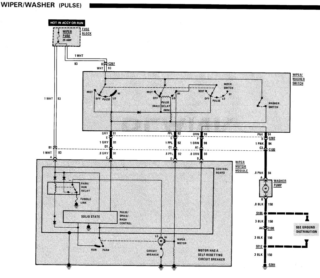

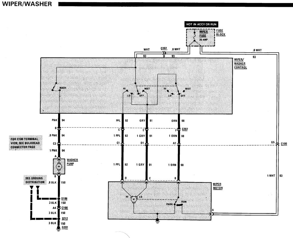

Welcome to the Forum !!
See if these help !
Mike

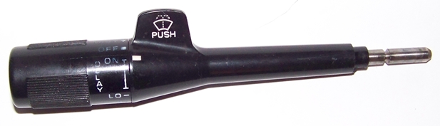

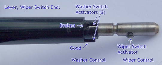

And...
Switch, turn/wiper(/cruse) lever, wiper motor, or pulse PC board can be bad.
Lever pulls out. See if plastic going into switch is cracked.
PC board in the wiper motor.
If switch is bad, usually switch is dead on one speed or all pulse.
Has it... only pulse

I have only had the car for a couple weeks and when I got it the guy said the wiper switch was bad. Basically the wiper lever spins freely so it's not even clicking with the switch inside the column.
Thanks for the fuse/circuit diagram. Now is there an easy way to basically make a mock switch with the provided fuse/wire information?

You will need to locate the wiper swith connector where it comes out of the column and disconnect it. Looks like from there you would put your switch between the white wire (power feed) and purple or grey (depends on speed you want). If you got a "on-off-on" switch you could hook up both speeds. If you want washer pump add a button to feed 12v to the pink wire.
I have not done this myself, just suggesting what might need done based on the diagram

You still haven't said whether it's got pulse or not. Only do what Mike has suggested if you have a non-pulse system. If it DOES have pulse, then you can't simply wire a toggle switch between the wires. If you look carefully at the switch itself of the pulse wire diagram, you'll see there's a resistor between the word "lo" on the switch and where it comes out as the grey wire. This resistor is presumably to drop the 12V at the switch to 5V for the solid state box called " Pulse/Speed/Wash Control". If you connect a toggle switch as Mike has suggested to a pulse system, you'll blow your control module and then you'll have even more problems.
Mike Gonzalez
Posts: 5093
Total ratings: 130
Report this Post12-09-2009 01:41 PM Click Here to See the Profile for Mike GonzalezSend a Private Message to Mike GonzalezDirect Link to This Post
Yes if you have pulse dont use the grey wire. You will only be able to use the high speed and use the purple wire.
Thanks Blooz, Meant to say that the first time....hadn't had enough coffee yet ! But please correct me if i'm wrong !

Turn Lever, Non Cruse
Cruse and Non Cruse, Turn Lever, wiper switch end.
