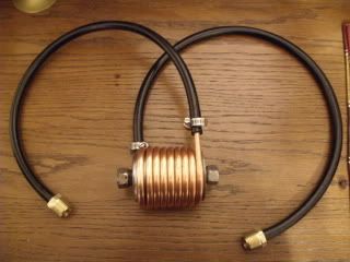

Here is what you do-
Get this marine oil cooler and plumb it into the 3/4 inch heater hose- http://www.cpperformance.com/detail.aspx?ID=892
You need to add a fuel pressure bypass regulator BEFORE the oil cooler and and only run one line up to the TBI- plug what used to be the return line at the TBI.
Then, run your fuel line from the filter, to the bypassing regulator (set for factory fuel pressure), then through the marine oil cooler and into the TBI. The only fuel that will get heated is what actually makes it up to the TBI, excess fuel is diverted back to the tank before it gets heated. Your fuel will come out of the oil cooler at whatever temp the engine is operating at- somewhere around 200 degrees. At this temp and 15 PSI of fuel pressure, most of the liquid fuel will vaporize as soon as it is sprayed into the throttle body.
Yes, I have thought about doing this for a while....

Report this Post07-26-2009 01:29 PM Click Here to See the Profile for White 84 SESend a Private Message to White 84 SEDirect Link to This Post
Wow! I will post a pic of one of those I already made out of copper tubing! Hmm.. now a fuel pressure regulator before the heater (cooler). Great solution!!! I foresee potential problems plugging the return. I think fuel may accumulate there anyway. Perhaps fill the cavities completely.
Now I have to give the higher fuel pressure pump and better fuel atomizing injecter idea a plus. I just dropped the tank and installed a new fuel pump that gets 14 psi. After installing a pressure guage I found I was getting only 6 psi. Anyway now the Duke really hauls a**! Before the fuel just more or less poured into the TBI. I thought that was normal but no..it isnt at all. So a well maintained fuel delivery system IS pretty darn good but I think this heater idea is one better.

Report this Post09-23-2009 02:36 PM Click Here to See the Profile for White 84 SESend a Private Message to White 84 SEDirect Link to This Post
Well here's the heater I came up with.
Any suggestions how to safely try it out?
84 Duke, Holley TBI, Manual Trans 4.10, CompuCam, White

Report this Post09-23-2009 03:31 PM Click Here to See the Profile for HudiniSend a Private Message to HudiniDirect Link to This Post
Just a wag but I'm thinking if you make no other changes it won't heat too much. All your fuel will be heated and the unused portion will be returned to the tank via the return line from the throttle body. Probably not much more heat than is passed to the fuel as it normally passes through the throttle body.
To get the most effect you would have to put a T in the fuel line before the filter. Then off the T have a fuel pressure regulator (12psi for the duke) and then the return line to the tank. You would also need to block off the return line from the TBI so that ALL fuel passing the filter goes to the engine.
Here is Darth Fiero's setup that I copied for a V6. Just place the filter after the T:

Report this Post09-23-2009 03:42 PM Click Here to See the Profile for White 84 SESend a Private Message to White 84 SEDirect Link to This Post
Cool....
If it isnt hot enough I would recirculate the TBI return directly back into the heater though. The filter seems like a pretty long dwell though. I would rather the tank not get at all warmed up.
Besides, the purpose of the thing is to warm the fuel to improve the viscosity and not as others have assumed to vaporize the gasoline Smokey Yunick style.

Report this Post09-24-2009 01:02 AM Click Here to See the Profile for HudiniSend a Private Message to HudiniDirect Link to This Post
What I'm suggesting would have only heated fuel reach the the TBI. There would not be any hot fuel returned to the tank as the T fitting is before the heater/filter thingy. The fuel would most likely reach coolant temp as the flow past the T would only be what flowed into the engine though the fuel injector. As this is a relatively low amount, it would have maximum time to the heat.

Report this Post09-24-2009 06:25 PM Click Here to See the Profile for White 84 SESend a Private Message to White 84 SEDirect Link to This Post
Sounds great but how would the fuel be diverted at the T from traveling up the wrong side of the injector? And with the injector rejected fuel where is the pressure to propell it through the T valve. This introduction of fuel to the Fuel pump pressurized mass will lower pressure for a second or so. Or would it?

White 84 SE
812 posts
Member since Nov 2008
O.K. dudes..I hooked it up last night. There was a flow issue. Apparently connecting up to both free coolant ports on the intake manifold is kinda like just hooking it up to one. So the coolant is reluctant to flow into my tubing unless there is an open end. Then it pours out and the copper get way hot. There is also a bunch of coolant spilled......so that wont work. My next thing will be to get longer tubing for one side and run it all the way over to where the runners are and connect there. In the drivers rear wheel well there is a rubber to metal union..that spot.
