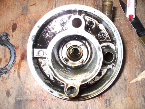

Here is my first attempt.
https://www.fiero.nl/forum/A...070315-2-077973.html
After a couple year it is leaking pretty bad again and caused my starter to stop working.
So I pulled it again. The cork gasket was pretty bad, smashed to the point were it split in several places. This was 2 layers of rubber impregnated cork gasket with gasket sealer between the layers and stuck to the flanges.
The part that was missing was stuck to the adapter, it wasn't missing just fell apart when I took it off.
I will swing by the store after work and see if I can find some good thick rubber gasket, 3/16 or thinker if I can.
The gasket was gone around the bolt holes and that is there I suspect it was leaking from all this time. But the gasket is shot at both mounting flanges.

Report this Post04-28-2009 07:48 PM Click Here to See the Profile for Jake_DragonSend a Private Message to Jake_DragonDirect Link to This Post
If the new gasket is leaking I will eat my hat. I think it has to be a hose fitting so I will pull those next. But it did start and ran long enough to run around the block before it started leaking again.
It could just be oil that was leaked into the frame as it didn't leak when I first started it. I will let it cool off and take a look at it again this weekend.
I used an inter-tube, it was pretty thick and should compress nice enough to hold a seal so it has to be a hose or fitting.

Report this Post04-28-2009 09:31 PM Click Here to See the Profile for Alex4mulaSend a Private Message to Alex4mulaDirect Link to This Post
Remember I went thru this? Being there done that. You need good thick 1/8" flat rubber. Anything less will not do. Tried all those. Archies latest is excellent. I was also able to find some (small piece for free) at an hydraulic hose strore. Check a local one. Ask for belt hose. Must be flat and not porous. Then the lower (big one) you need to cut it kind close to inside and outside but not too close. On the outside it should not buldge or very very little when installed. The inner one need to cover the bolt holes very nice. I only used RTV on the bolts to cap area. The two gasket went dry. Sealed perfectly and clean. I also have gasket material if you need. Good luck.

Report this Post04-28-2009 09:58 PM Click Here to See the Profile for Jake_DragonSend a Private Message to Jake_DragonDirect Link to This Post
Thanks Alex, I have been looking at the hoses and fittings. The "gasket" is about 1/16 thick and should compress well enough to seal.
It could be the fittings who knows. I wish there was a different way to mount the starter so a stock filter could be used.
I have had nothing but trouble out of the adapter.

It is a pain to get it right. But once it is it works fine. I still think 1/16 is too thin. I did it three times until I got it right last time. So I know the pain.

Report this Post05-11-2009 09:50 PM Click Here to See the Profile for Jake_DragonSend a Private Message to Jake_DragonDirect Link to This Post
OK found my leak. Its the elbow leaking. So I need to know what the threads are so I can pick some up on the way home tomorrow.

Report this Post05-23-2009 08:05 PM Click Here to See the Profile for Jake_DragonSend a Private Message to Jake_DragonDirect Link to This Post
Well initial results are the elbow was leaking. I installed a new one and had to modify the adapter to get the elbow in the correct direction.
So far no leaks.

Report this Post05-25-2009 12:41 PM Click Here to See the Profile for Jake_DragonSend a Private Message to Jake_DragonDirect Link to This Post
Well I put about 25 miles on it over the last 2 days and it hasn't leaked at all.
Now I can drive it to work while I work on the Vette.
Never rule out things that you know cant be the problem. I have looked at those elbows a 100 times and never once thought it was one of them. Turns out the only thing hold the one in was the Teflon tape.
